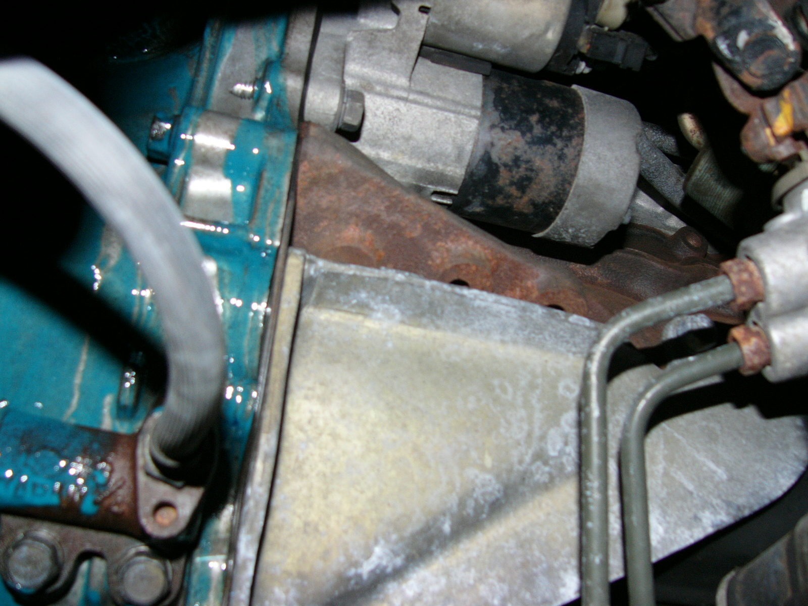

R33 Gtst 5 Spd Tranny Leaking Oil Through Vent Tube

I don't get in here much anymore but I can help you with this. The hole is a vent (air relief) for the brake proportioning valve, which is built into the master cylinder. The bad news is that if brake fluid is leaking from that hole then it's getting past the proportioning valve seals. The really bad news is that no spare parts are available for the proportioning valve either from Nissan or after market. It's a bit of a PITA getting the proportioning valve out of the master cylinder body anyway but, fortunately, leaks from that area are rare in my experience. BTW, if those are copper (as such) brake lines you should get rid of them. Bundy (steel) tube is a far better choice (and legal in Australia - if that's where you are).
