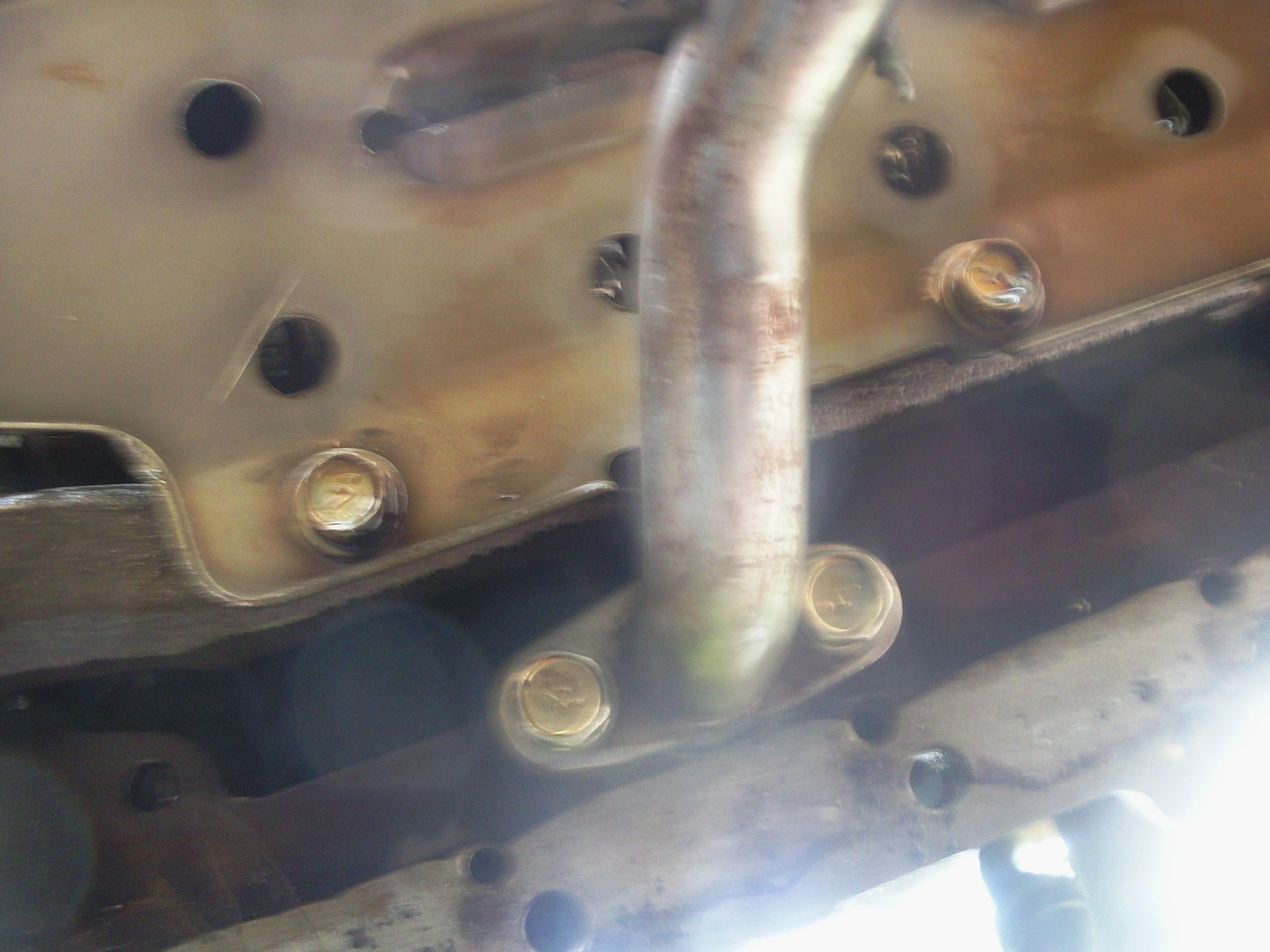

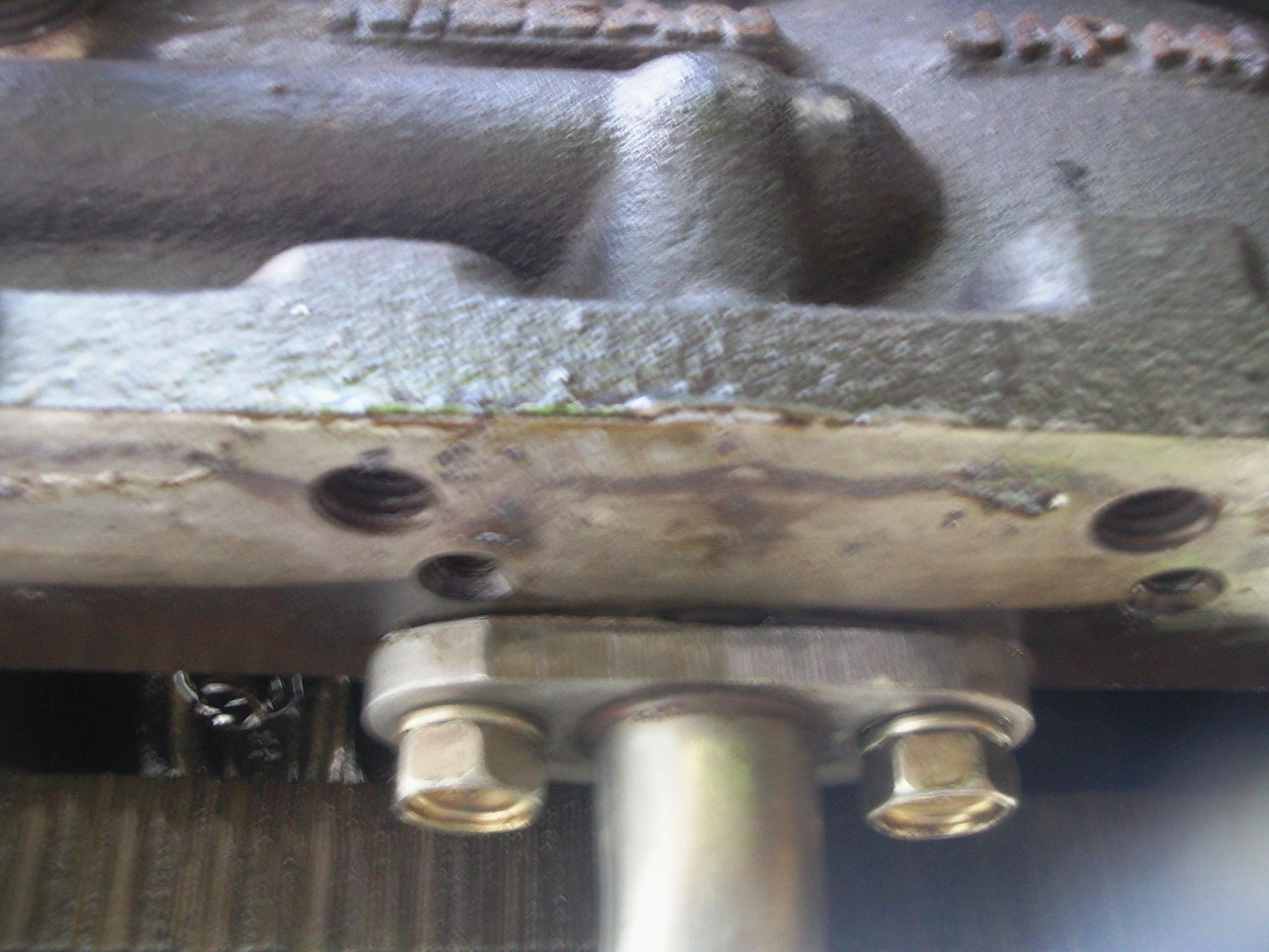

hey,
so i figured out why my engine didnt start, was vacuum thing,
so i ran the engine and quickly did the timing, engine wouldnt of been on more than 2mins,
i checked my defi oil pressure gauge and i have no oil pressure
i did have the oil pick up off the car, and i did grind a bit away so it would fit with the sump i bent to fit, i know sounds dodgey,
heres some pics of what i did, but do you think this would be the reason for the no oil pressure?
i have the gasket and everything on there and did the bolts up tight,
any help would be good,
Thanks JV

mmm thats what i fear, does any1 know of any1 who makes or stocks custom sumps to convert the car from awd to rwd? if so please post up name, i dont wanna pay more then $400 for 1, and then that way i dont need to grind away the oil pick up because thats where the problem could be?,
ive noticed in the second pic u can see a gap, but then on the 20 pick up there is another ring that should seal i hope,
i dno, i will have to pull the engine out for the 4th time and pull the sump off,

so you dont think its because i grinded back the pick up? i cant see how it could be, it would still seal?

the rb20 pick up looks like it has a recess, so i think i must need to put a o-ring in, god damn it, so can i do this in the car? or will i have tor ip the engine out? if its in the car whats a easy way to get the sump out? any info would be good,

sweet as, yeah once the sump is off its easy, i might even be able to do it without unbolting the engine, might be a very tight fit but o well, ive gotta try and file some of the holes i drilled out anyways, i might try and just find the 25 pick up as that doesnt need the o-ring, and thats also why it would be sucking air, i grinded it pretty far back that it made a gap in the o-ring spot as you can see in the second picture, will update this once i do the mods let you know if it worked,

ok so i got round to working on my engine, i got the sump off and had a look, straight away i saw the problem, i thought it might have been the pickup with grinding it back, but what i must have done while re-installing the oil pick for good, i bolted it onto the wrong spot, (yes this can be done) ther is another spot about 4-5cm further back where the oil pick up can be bolted on, so pretty much i had no oil pick up on my car and thats why i had no oil pressure, i changed the pick up to the rb25 pickup just because it doesnt need a o-ring, better safe then sorry,
oil pressure went straight up to 4kg, then i saw the welsh plug leak, god damn it,
will post up pics of my screw up so people can see,
