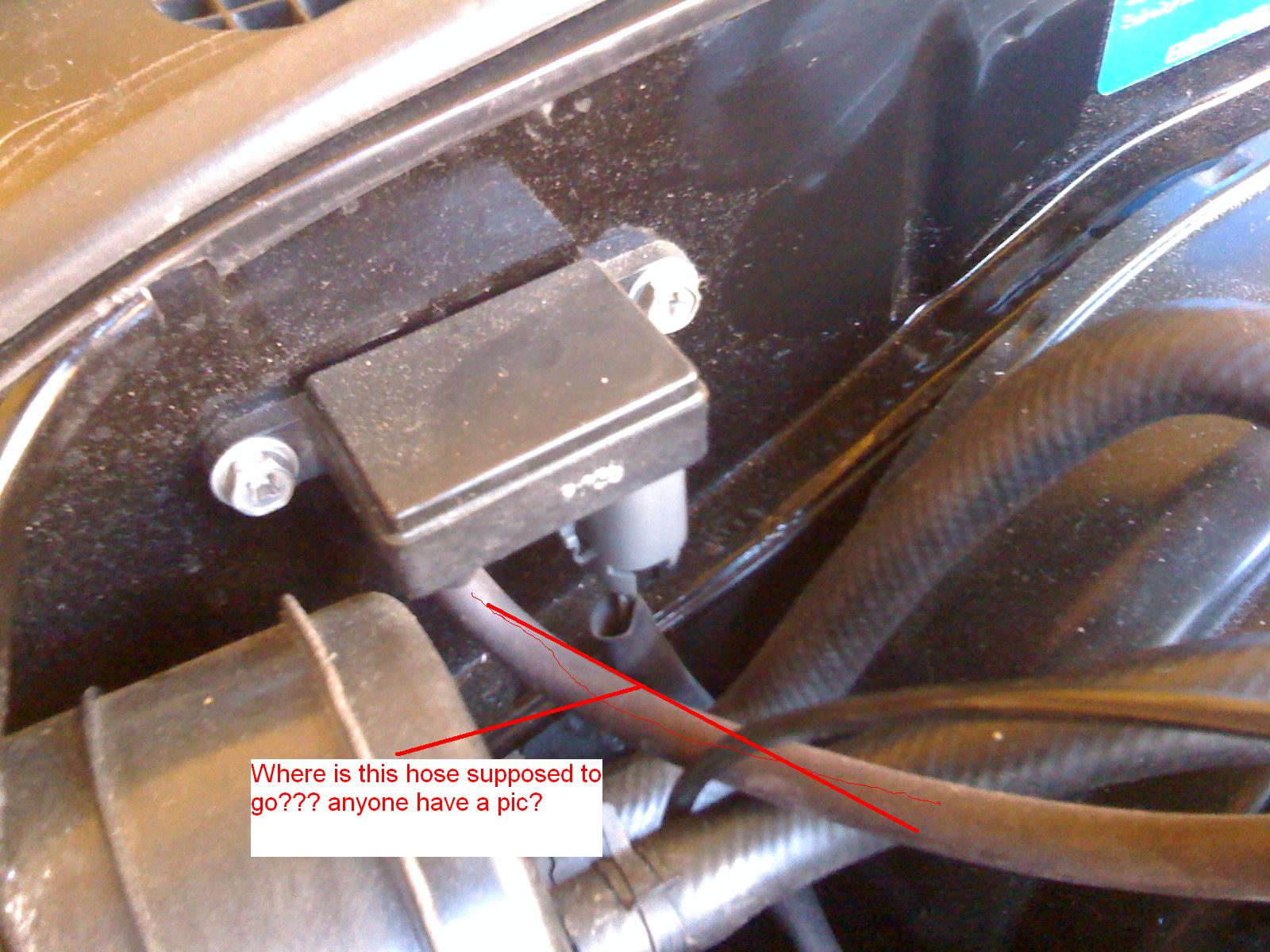

Hey mate you were right, the hose has come off but I cant find where it has come off from, I've looked around the #6 injector but can't find a stem to connect the hose to?
That black box in the picture is the stock boost guage, the hose it uses runs into the rear of the balance tube, which in turn is connected to the pressure regulator.

Hey mate thanks a lot for that, its all sorted now.
