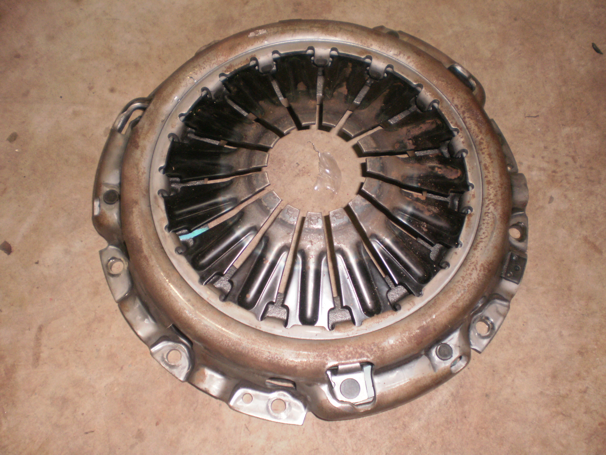

hey every1.. after finally gettin my silvia running i found that the clutch wouldent disengage.. so i tried bleeding it and that didnt help then i looked through the hole where the fork goes through and measured the fork movement (20mm) and everything seemed to be working fine( the fork was moving the diaphragm heaps) ... so this afternoon i pulled the box off and my mate is not shure but thinks this is a pull type clutch... can anybody please tell me?? running rb26 with a rb25 box .. thankyou.. wat a pain in the ass...

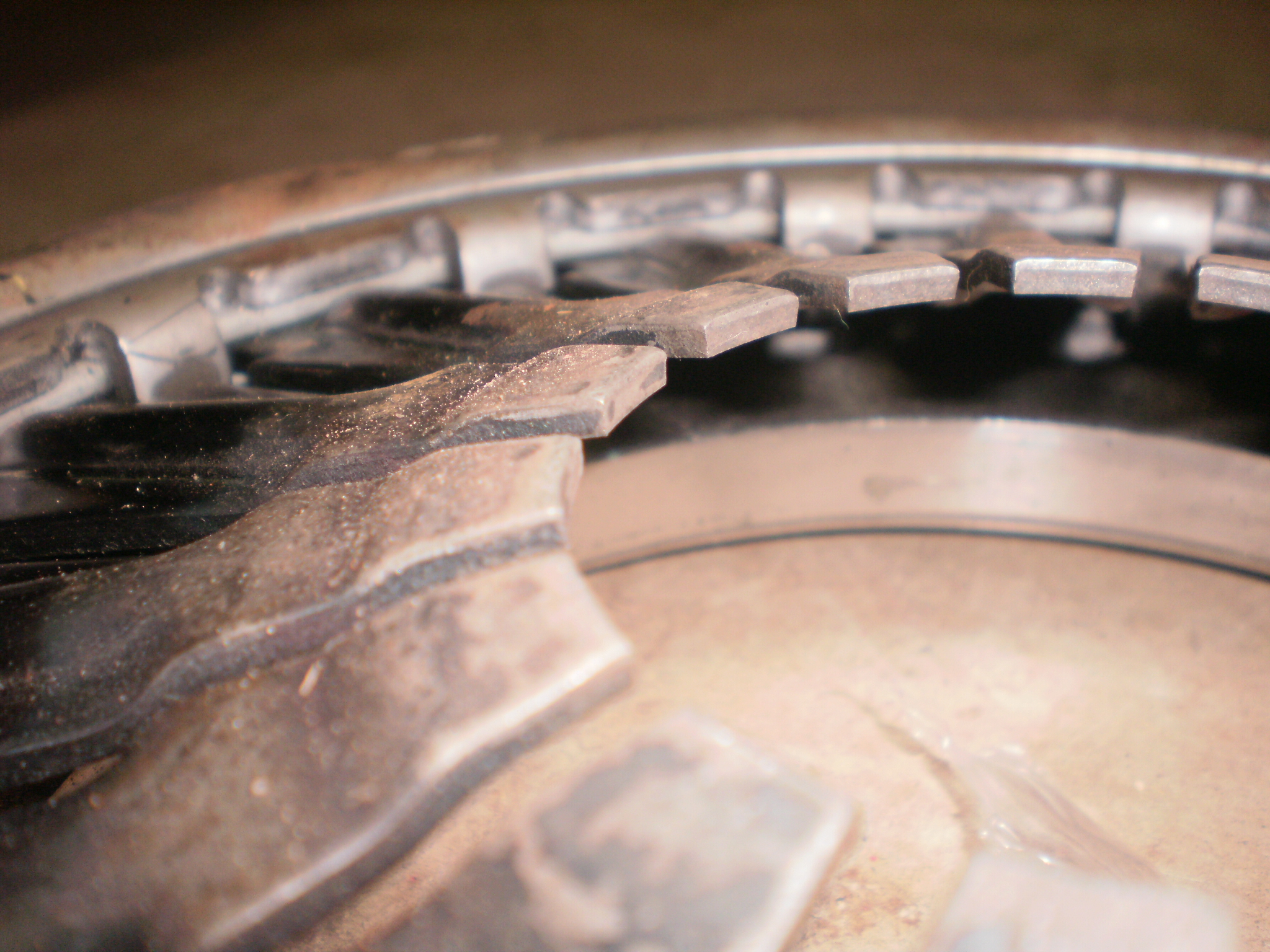

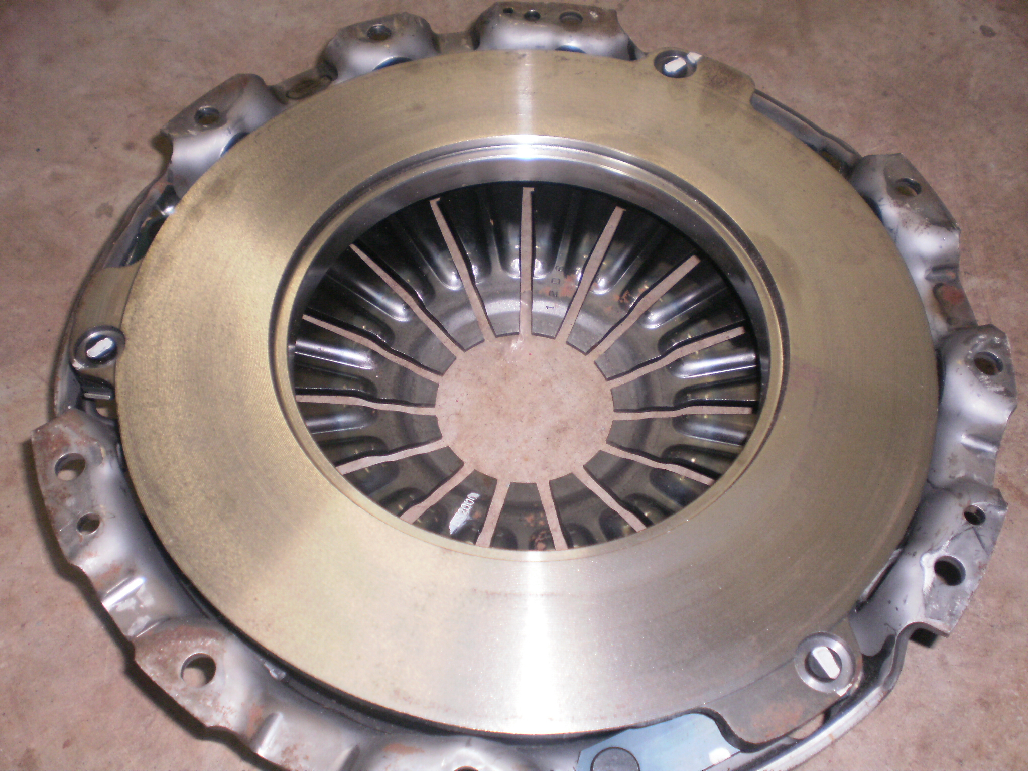

didnt try adjusting the pedal... but the piston was nearly coming all the way out of the slave.. so we tried a bigger shaft in the slave and still no good.. the fork was moving the fingers 20mm... just looks suspect how on that pull type clutch andrew posted u see the fingers curve up at the end.. mine does that to......
anybody have and ideas why this wouldent work then?? ive got a billet flywheel aswell... i think its a bit thinner then standard... should i have a differnet throughout bearing aswell or something??
its not that... i rang npc today and they are confused as the why this is happening... the only thing they can think of it is to see if the pressure plate is working correctly.. ive gotta drive up there in the next few days... ill post up when i figure it out.. thanx mate
