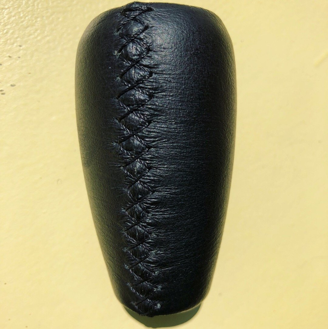

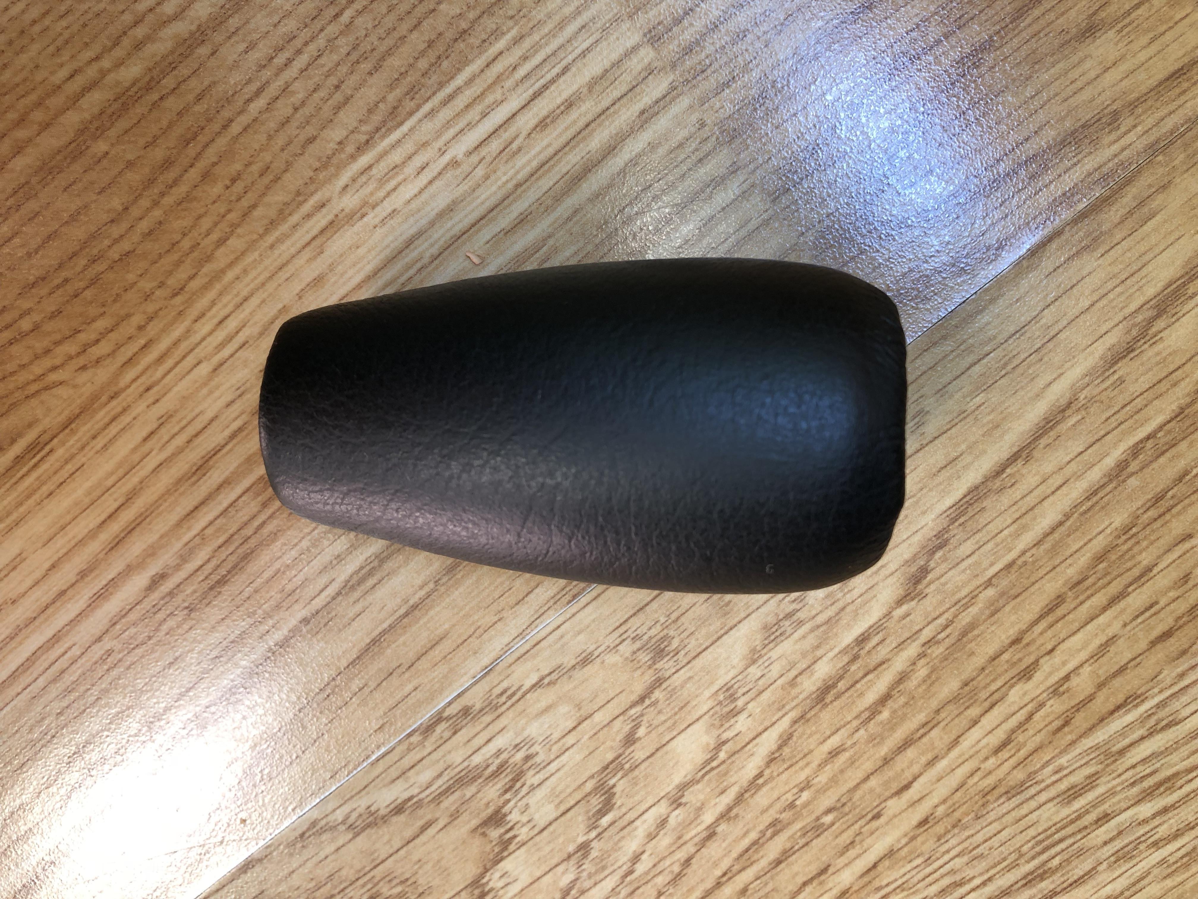

Old Logo 1995/97 Leather shift knob been re-upholstered with real quality leather, medallion has a bit of a wave to it but apart from that in perfect condition. Rare 10 x 1.25 fit as most these came in 8mm
275 USD
Worldwide Shipping 40 USD
paypal 4.4%
