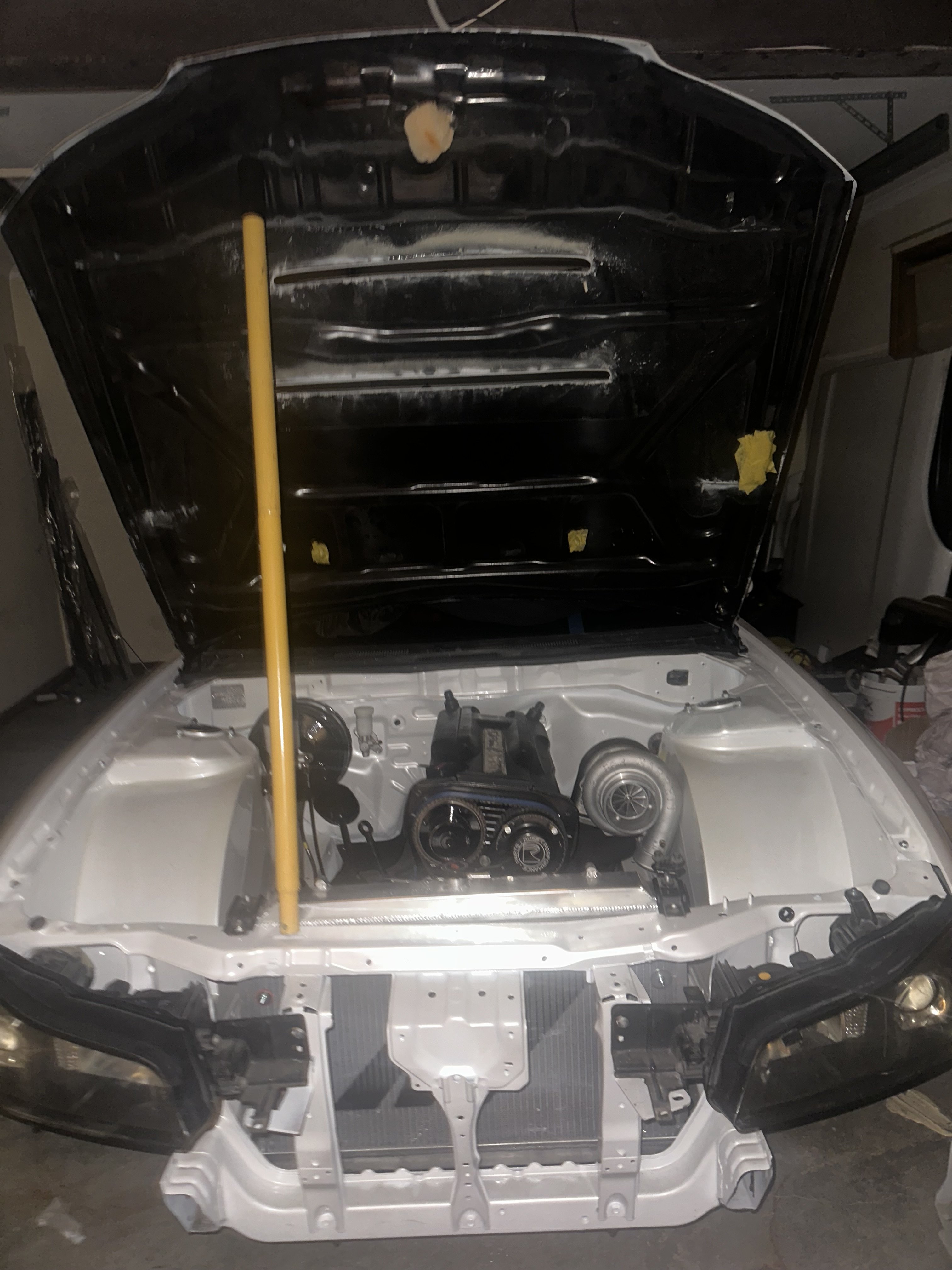

On 05/07/2025 at 11:31 AM, tidi0x said:
Just wanted to pop in an update on my setup. The CD swap has been great, I love the mazworks housing for the overall simplicity. I ended up sealing my trans tunnel with a thin sheet of aluminum reused some of the holes on the trans tunnel, and laid some window sealing EPS foam around the edges. Works great, really quieted things down and sealed up the car.
As for the power comment. Right now I am also running about 650whp. with the way the bell housing is attached to the face of the transmission I have zero doubts it would be fine, mainly because the input shaft and main shaft bearings are seated into the bell housing adapter. This means the load is NOT on the bolts to maintain the power, rather into he casing of the bell housing; Yes the bolts are doing some work there, but with both shafts locked in zero worries.
End of the day, the Mazworks solution is the easiest and safest. no need to take your trans to a shop to get milled perfectly, it fits with minimal clearancing, and you can use all your existing clutch and flywheel.
Driving wise the CD has been great compared to the big box, I'll probably swap my final drive at some point. The serial 9 shifter is gooooood, my only qualm is how tight it is, it takes a fair bit to get use to, 5th and 6th are a bit eh/hard to find at times, but maybe I need re-adjusting, and I think my clutch master is very tired and needs a rebuild.
I've also heard good things about the Mazworks. Does it center the shifter properly like milling the bell housing does? The serial 9 shifter takes some time to get use to. It's hard to blame the shifter though, by design 5 and 6 on a CD009 are very close to 3rd and forth. It's very easy to shift into 3rd instead of 5th.
