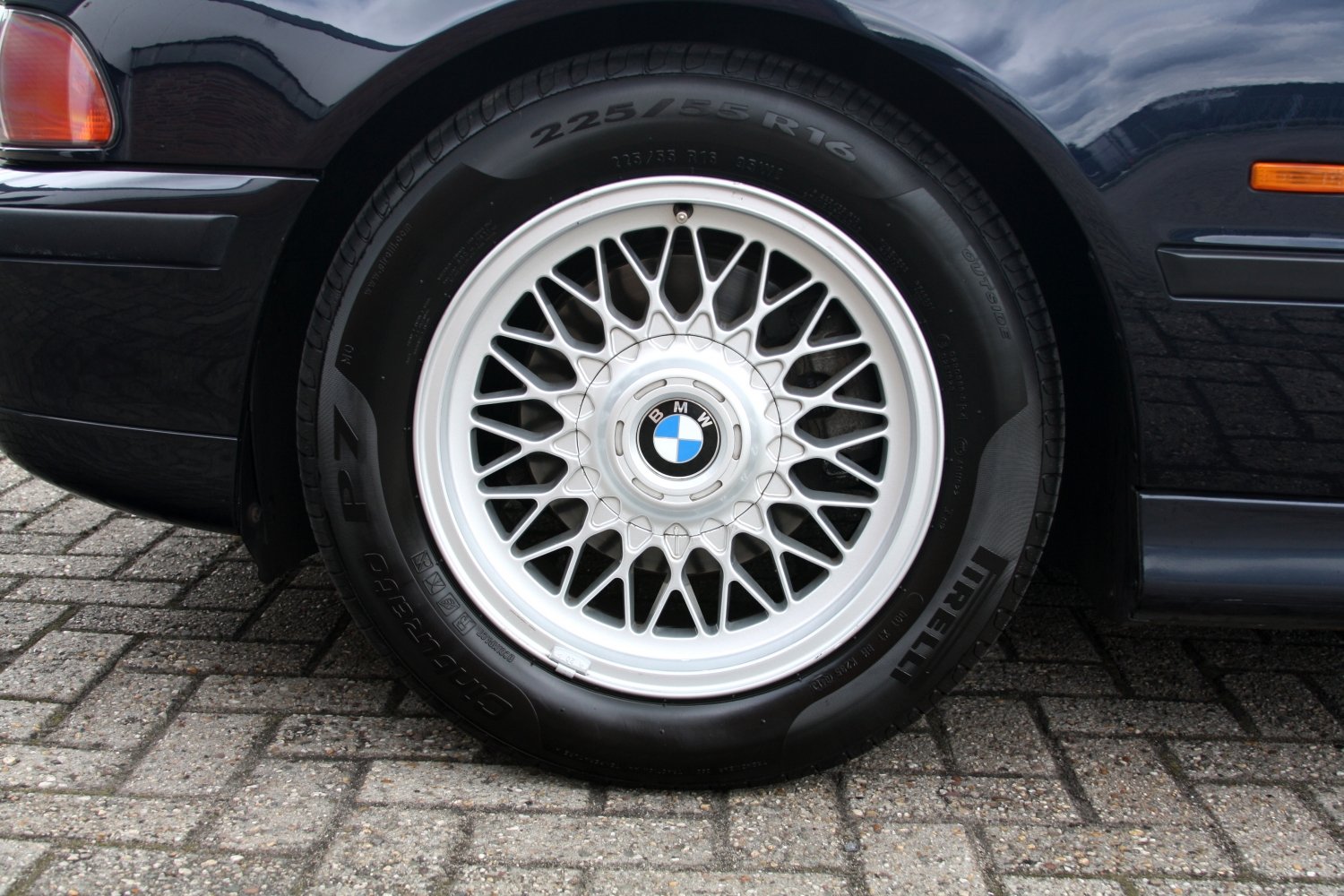

1 hour ago, GTSBoy said:
These going to fit over the big brakes? I'd be reeeeeeeeaaaall hesitant to believe so.
Well, apparently they do fit, however this wont be a problem if not because the car will be stationary while i do the suspension work. I was just going to use the 16's to roll the old girl around if I needed to. I just need to get the E90 back on the road first.
Well, that's kinda the point. The calipers might interfere with the inside of the barrels 16" rims are only about 14" inside the barrels, which is ~350mm, and 334mm rotors only leave about 8mm outboard for the caliper before you get to 350, And.... that;s not gunna be enough. If the rims have a larger ID than that, you might sneak it in. I'd be putting a measuring stick inside the wheel and eyeballing the extra required for the caliper outboard of the rotor before committing to bolting it all on.
  • Like 1
Thanks for that, I'll check it all out. I can always do the brakes last anyway if its a problem.
The 16's are super cool, if they do fit I'll cruise around with them for a bit.
