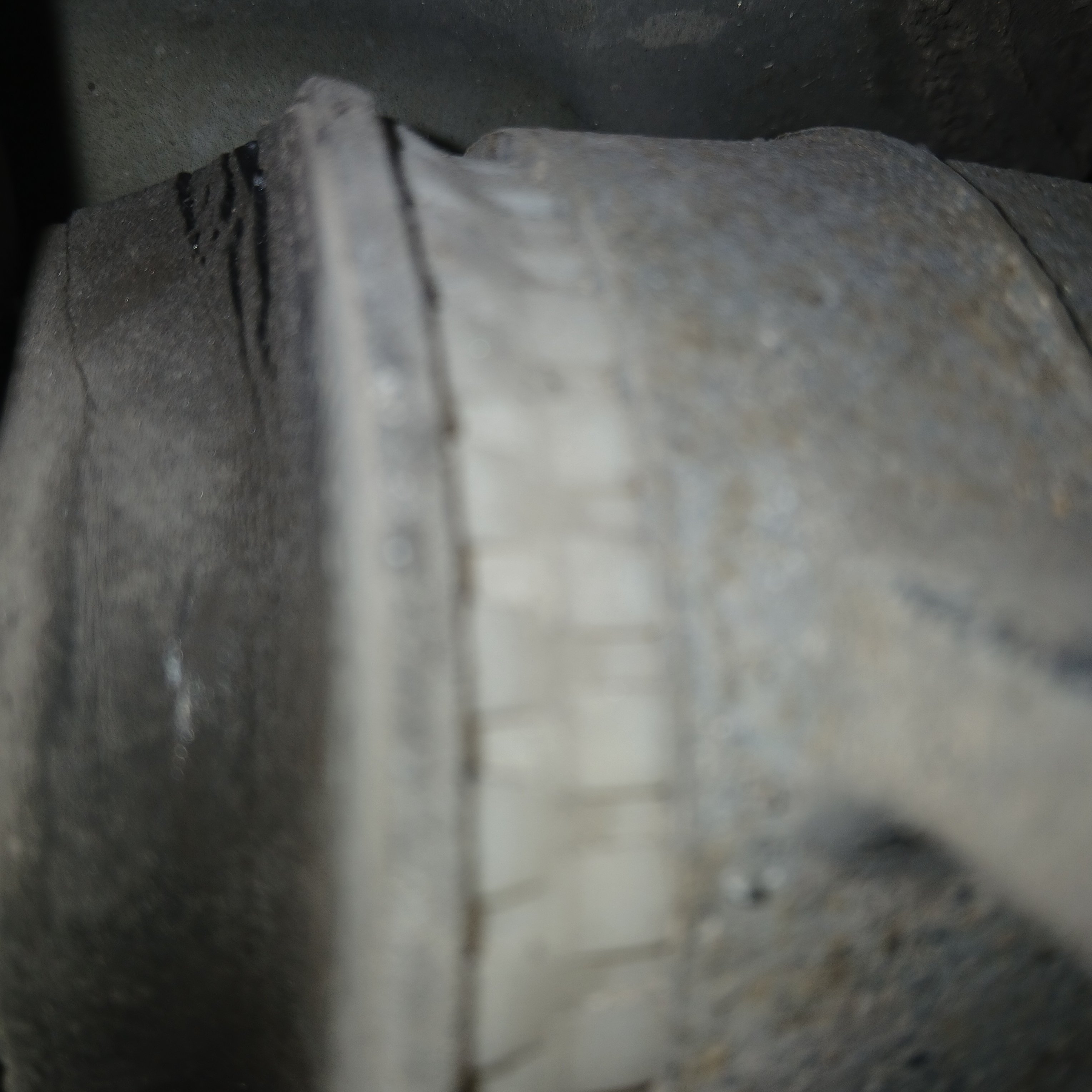

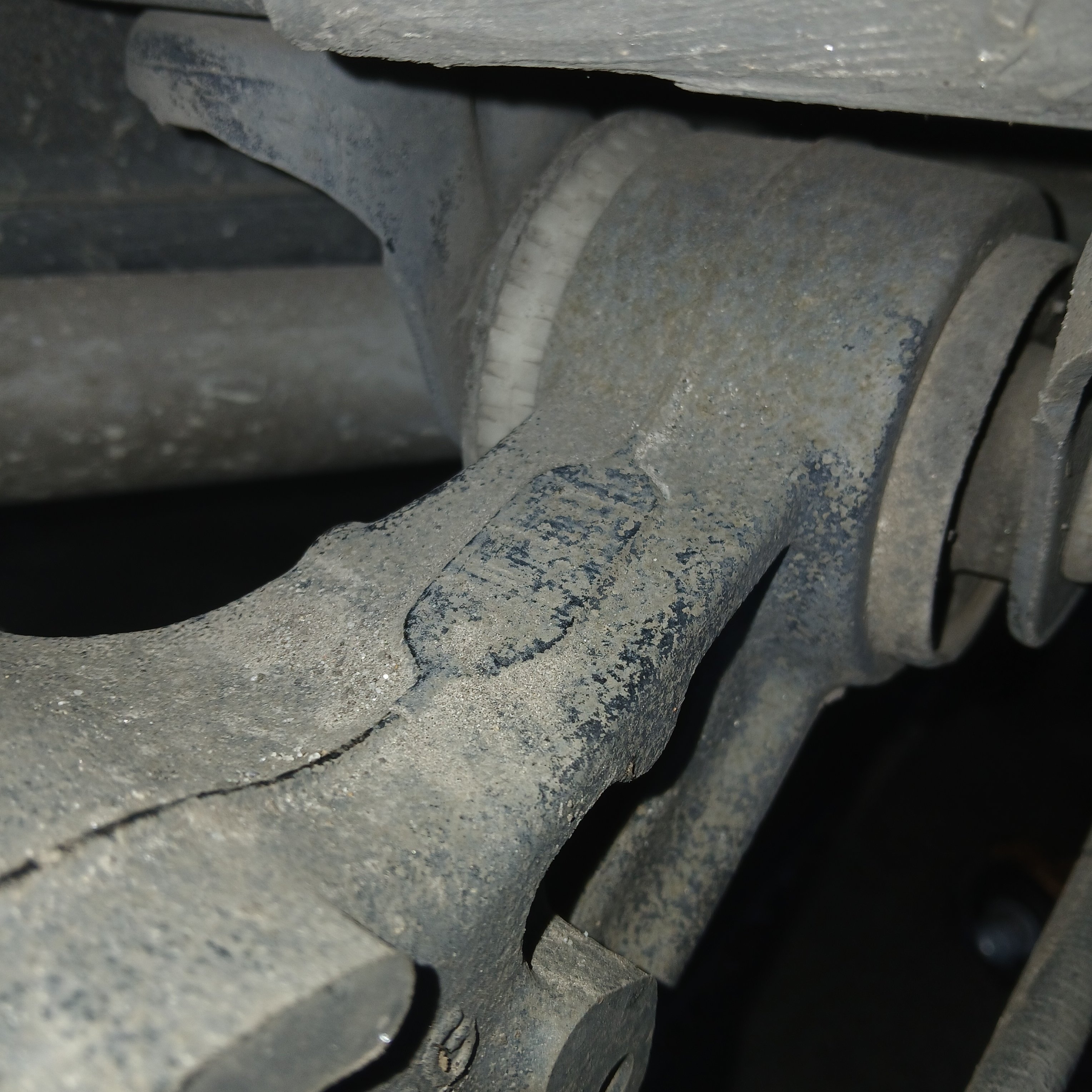

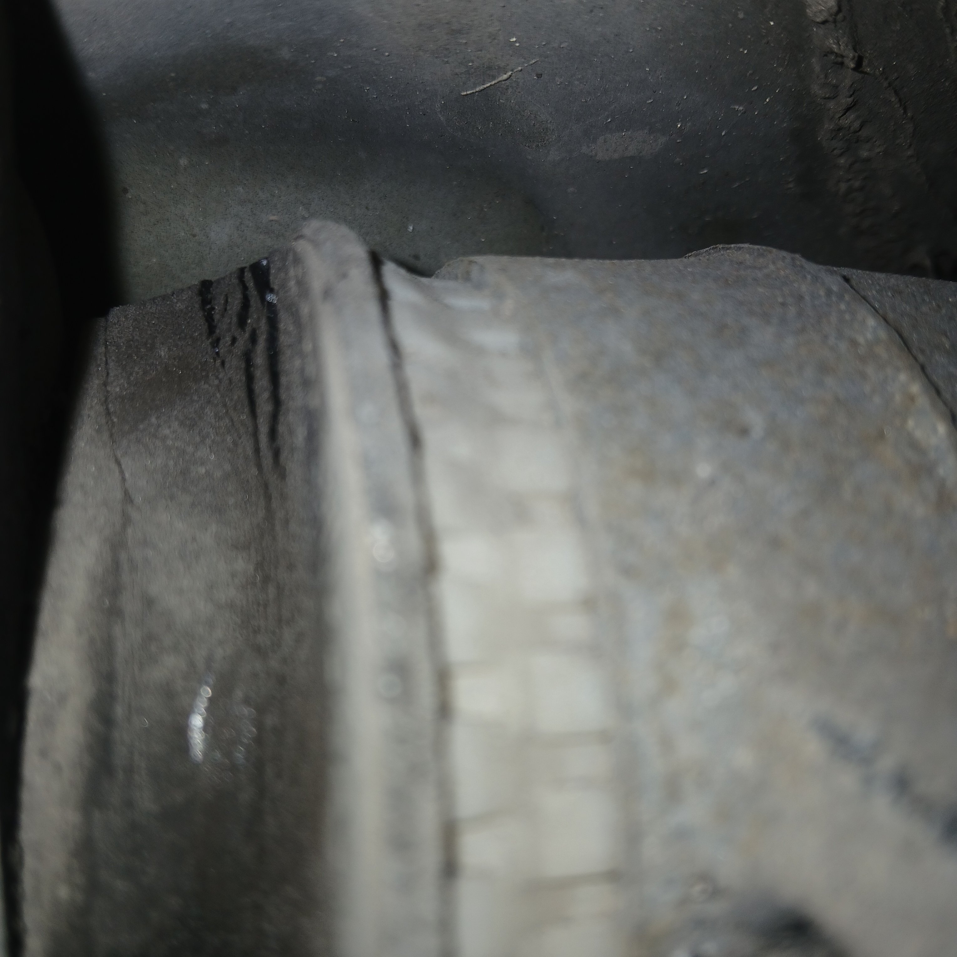

surely that is a control arm, not a sway bar.
In any case, visual condition should not be an issue, excessive movement under load (eg with a big pry bar) would be the issue. I can't see 99.999% of pink slip places even looking, let alone trying to test it
