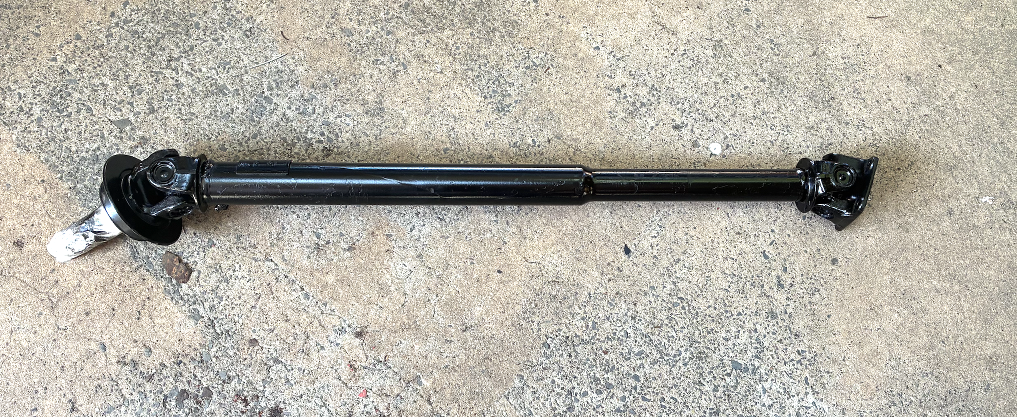

The front prop shaft from my GTR had very notchy unis, which obviously needed replacement but unfortunately uses the (usually) non-replaceable (staked) type. A new shaft is something like $2K plus shipping from Japan. I wouldn't even bother asking the local Nissan spares dept. Rang Hardy Spicer but no go, which surprised me a little. There's a place over Dandenong way that would make me a 'performance' shaft but un-necessary in my situation. They claimed to be getting the equipment in to replace staked unis but couldn't give me a timeframe. Anyway, long story short, found a place to do the work just 5 mins from me: https://knoxdriveshafts.com.au $420 (cash) and about a week later I have my driveshaft back. Price includes balancing. Owner is a one man band working out of a shed in his backyard but from what I could see he's very well setup with some expensive equipment.
