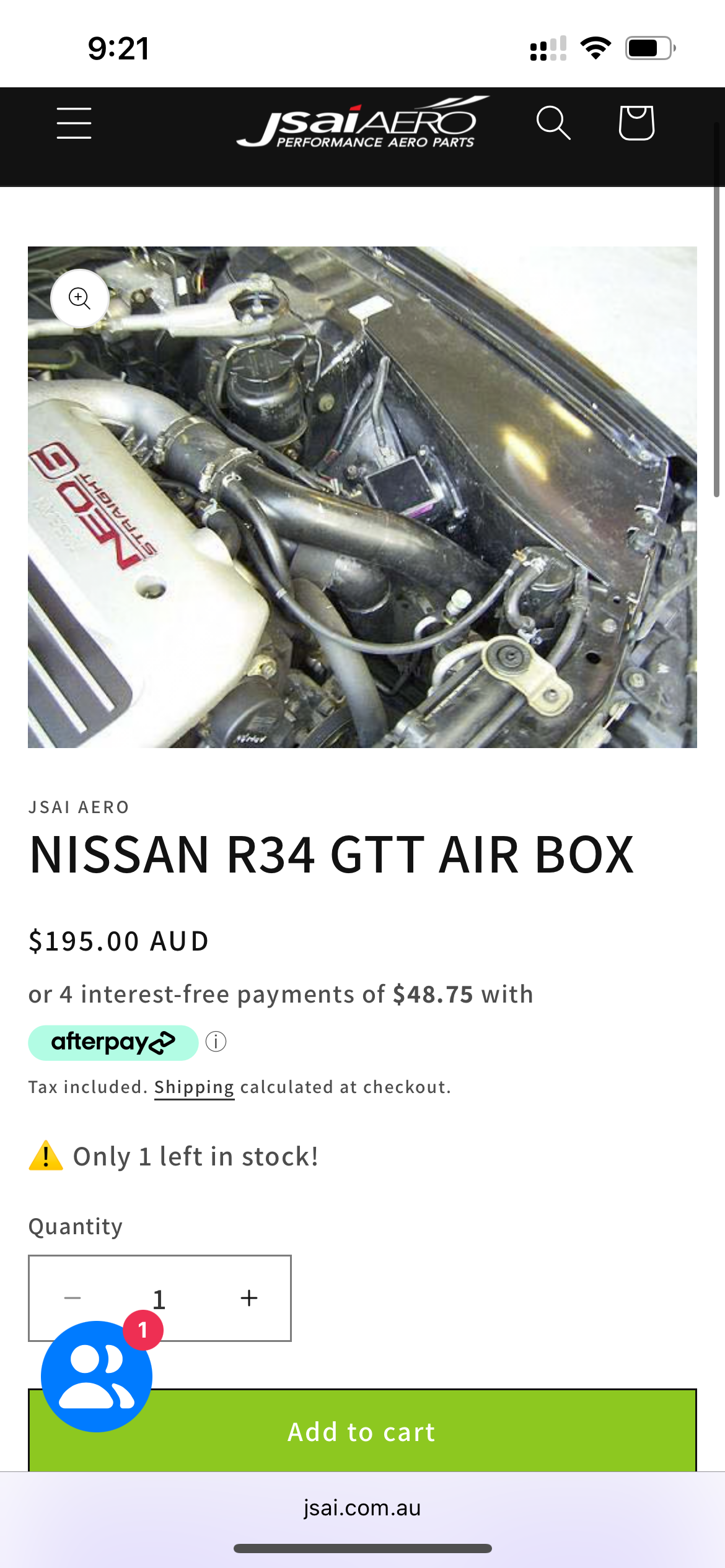

Also seen this as an option

Well you could certainly buy or build an enclosure for a pod in that corner of the bay. It is absolutely vital that there is a nice big opening to let cold air in to it from the front or underside, otherwise it will just pull air in around the edges from the bay, and if that air is hot, you gain nothing from enclosing the pod.
There is lots of good evidence around (including on here, see posts by @Kinkstaah for example) showing that pods pulling hot air from the bay is only a problem when you're static or slow in traffic, and that as soon as you get the car up and moving the air being grabbed by the pod cools down. Although that will obviously vary from car to car, whether there is a flow of cold air to the pod or if it all has to come through the radiator area, etc etc. Obviously, the whole exercise requires as much thought as anything else does. Doing the lazy thing will often end up being the dumb thing.
The stock GTT airbox has a cold air snorkel to feed it from over the radiator. Shows that Nissan were thinking.
The GT airbox is upside down compared to the turbo one, yeah? Inlet at the bottom, AFM/exit on the lid? That might make it harder to route the turbo inlet pipe using the GT airbox than a turbo one. That would probably be the main reason I'd consider not using it, not that it is too small and restrictive. I'm looking at a photo of one now and the inlet opening seems nice and large. Also seems to have the same type of snorkel that the turbo one has. Maybe all that's required is to make a less restrictive snorkel/cold air inlet, perhaps by punching down through the guard like I did.
