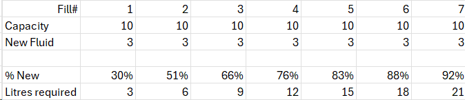

You need a heap of compatible transmission oil. Could be Nissan, could be anything else rated for Nissan Matic S. You need at least 10 litres, I had 15 to give it a better flush...
