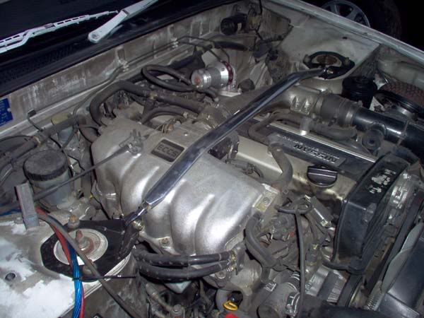

Ok so ABS/TCS is "not" the problem. Yeah i know now about the ABS with Nistune(i told that to the Nistune guy) but iam not 100% why or why i dont have ABS. ABS cube is in the engine (always has been) but i had braked couple of times rly hard and brakes just locked and scream. Does all Skylines have ABS cube? That boost sensor https://www.sau.com.au/forums/topic/367633-wtb-r34-gtt-turbo-pressure-sensor-pics-inside/ Is this it? I need to ask but i have a picture of engine bay and i do not see that (100% is not in that place) If i do not have this the car can do what mine is?(cutting around 4000 rpm) Here is the pic of my engine bay(only one i have) BUT i think i dont have that cuz loom was used from my RB20DE NEO and i know (obviously) that it does not have boost control or any wire to that...) so maybe that is the problem? (i dont know for 100% if that car where the engine is from had that)...but i dont have the loom from that
