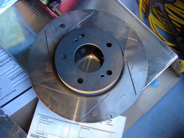

As recommended by the brakes sticky i got some R33 rotors machined down 6mm for my S2 Turbo.
I have found that these DO NOT fit. They sit too far back and rub against the caliper so do not buy them unless you feel like grinding the caliper away, which i am going to do over the weekend. I would recommend going with the genuine items from Nissan or upgrading the calipers.

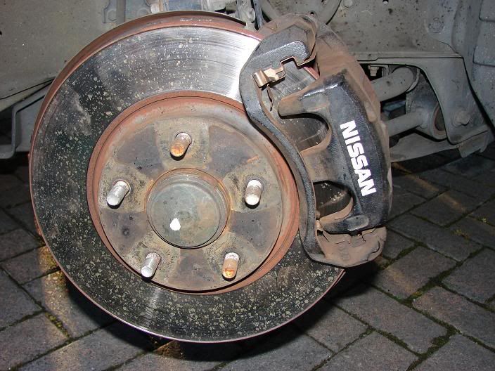

Heres some pics of the gear. The new disc fouls on the back side against the top outside edge of the caliper support.
I think the recommendation should be removed from the brakes sticky but i dunno whether that will happen.
DO you have a pic of where they are hitting, or can you draw up some tricky paint picture? If the rotor is not sitting in the centre of the caliper you can just space it out with some shims, if the disc is too wide in diamter, machine it down a bit more?
Hey there. Ive hacked up an image of where it contacts. Its rubbing on the back side edge of the disc against the caliper support. I think the offset is different to the standard disc and i think the disc might be a bit wider as well so im having my doubts as to whether these are going to work at all.
Im going to see if i can fit the new disc and new pads in the caliper tomorrow. If i can get that to work i think i will see if the disc sits in the centre of the caliper. If it does i will grind the caliper support a bit. If its not centred then i may look into getting spacers.
If the new gear doesnt fit in the caliper then i think i will throw in the towel and have an expensive set of paper weights, im expecting this and after spending about $450 on discs and machining im pretty pissed off about it to be honest, only myself to blame for relying on the internet i guess.
Moral of the story so far is dont trust internet forums to give you the correct parts fitments.
Circled is the contact area.
Righto. Had a bit of a play around today. The R33 rotors will not fit at all without a 5mm spacer behind the rotor. Im not sure if this is dodgy or what. Also i believe the R33 rotor is wider at 30mm when the original rotor appears to be 28mm. So even with a spacer you would need the pads machined down to fit in the caliper.

The dimensions I was given for the front rotors for an S2 Stagea were off an RS4. I have fitted the R33GTST rotors to an S2 RS4 and they fit perfectly (after machining down the 6 mm of course). So I can only assume that the RS-V is different. The way to confirm this is to measure the standard RS-V rotors.
These are the dimensions of the RS4 front rotor (R33GTST in brackets);
OD = 290 mm (296 mm)
New height = 54 mm (54 mm)
New rotor thickness = 28 mm (30 mm)
Minimum thickness = 26 mm (28 mm)
Centre hole ID= 68 mm (68 mm)
Studs = 5 (5)
Obviously the dimension in question is the height (ie; 54 mm).
It is worth mention that ALL R32's, R33's, R34's (including Brembo equipped ones) plus S14's and S15's come with front rotors of 54 mm height.
There was sufficient room (with the pistons fully retracted in the callipers) to fit the Bendix brake padss, ie; the extra 1 mm of rotor thickness (each side), was not an issue.
