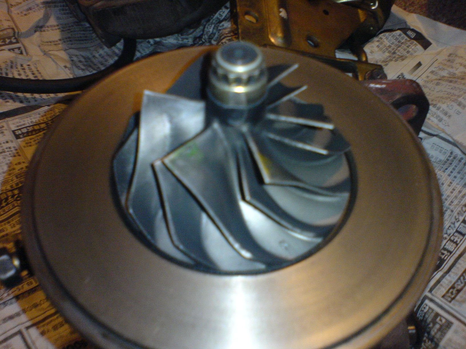

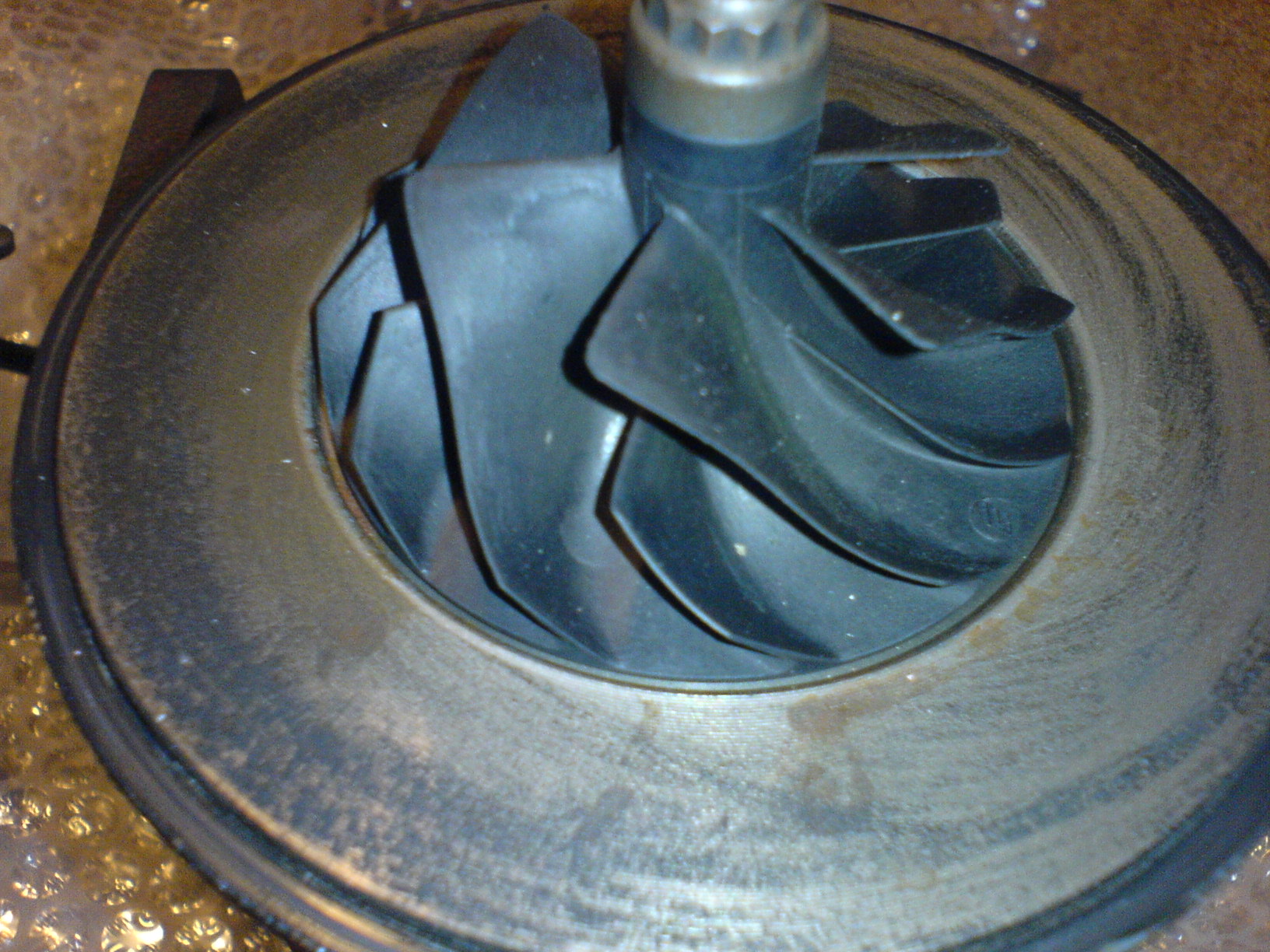

just in case anyone is interested here are a fewpics with the compressor covers off
Steel wheel
Nylon/Plastic wheel
when i put my car back together i'm going to use the series 2 one, its newer and from what everyone is saying it performs a little bit better at standard boost. i just had to go through the process of drilling out broken exhaust manifold bolts, 5 in total :P so i have the turbo out anyway.
