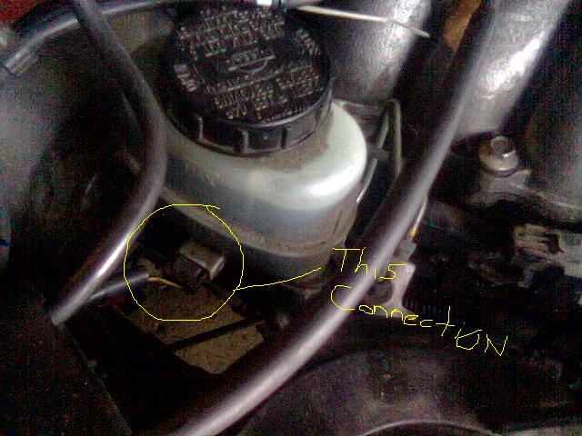

as per the attachment, that connection going into the resevoir, what is it for???, as we done an auto to manual conversion in the weekend, and forgot to plug that connection in, and coincidentally at the same time, the brakes started to engage on their own after some 10mins of driving, and the brake pedal was extremely hard, and they all were smelling, was this the cause for it, im hoping so:)

That wiring plug is just for the low brake fluid warning light.
Have you messed up something with the brake pedal installation when you put the manual pedal box in? From memory the link rod from the pedal to master cylinder is adjustable..... ie, are the brakes constantly engaging?, and just getting worse as they heat up, and in turn, bind up. (until of course they just fade, then catch fire).

hey ok, now that worries me again. I cant test as i have said, but if what you say is true, then i need to check elsewhere.The brakes arent engaged all the time, i mean i test this by parking on a hill and leaving it in netral and handbrake down...car rolls......now after ten minutes or thereabouts of driving, park up on hill leave it in neutral and handbrake down.....car doesnt even move!, and the brake pedal is nearly fully engaged.....whats the cayuse of this, im scared to drive anywhere right now.oh and every time i touch the brake pedal,i hear a noticeable click noise.
can you post a link on how to adjust the link rod, if thats the cause, and is their a factory setting it should be set at....im going to have to try one by one i guess.....coudl this also affect my power steering, as right now its extremely heavy!
another question: since i replaced the brake pedalbox from the auto one to a manual one when doing the conversion, was the brake master cylinder supposed to be bled in aswell??
