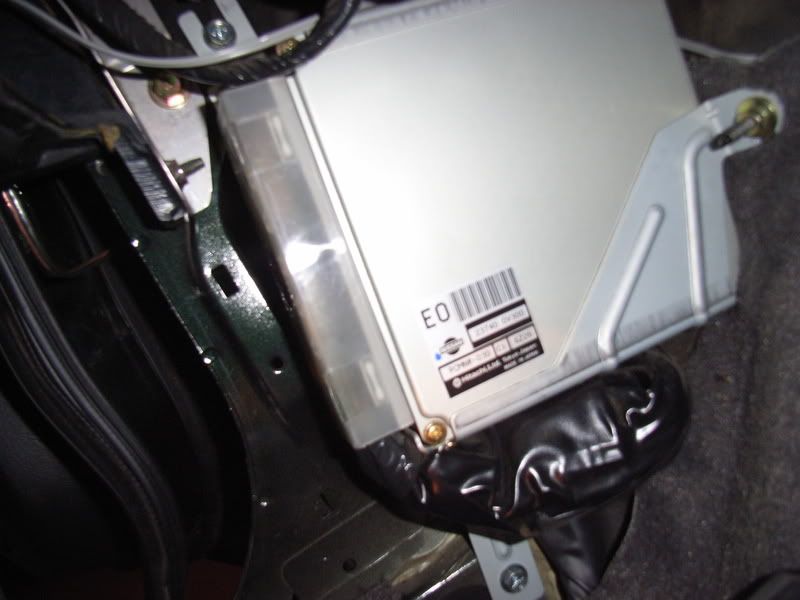

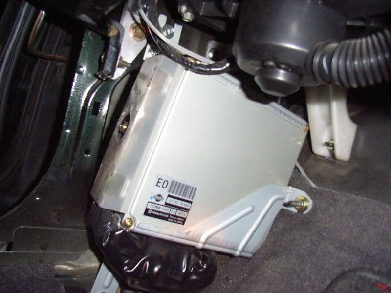

From what I can see in FAST for S1's the original ECU was P/N: 23740-0V300, then it changed to 23740-0V301, then to 23740-0V310,
and then there's an alternate number which is 2374M-0V310.
Doesn't explain much though, and you wouldn't think the wiring would change.
Ah well, will wait to see what differences there is.
Ive got an early model stock ECU, so she'll be right
