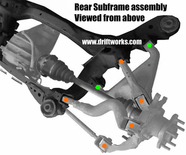

Use the GKTech subframe bush and bring your subframe 10mm closer to the chassis. You'll need to fix an exhaust hanger to suit. One of the best mods I've done. -

Perfect, I'll get to it this winter then at the same time as I weld on my anti squat kit. -
