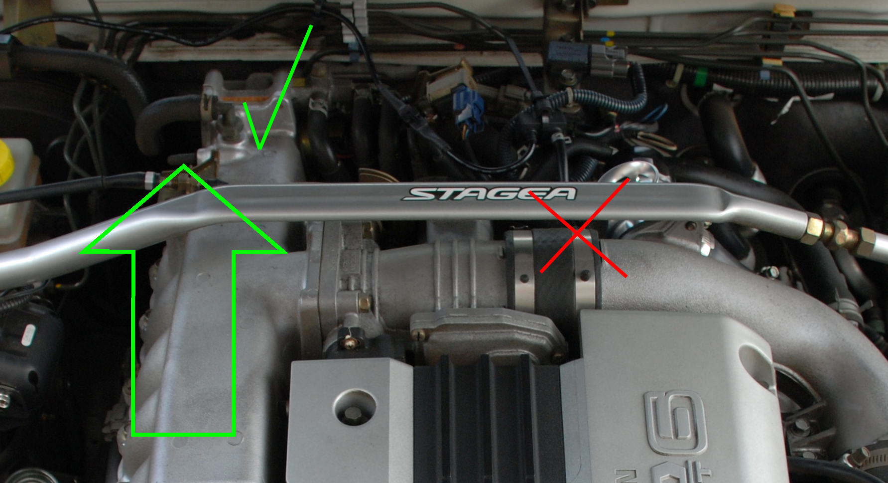

I have just bought an Autometer Pro-Comp Ultra-Lite boost gauge Autometer gauge
I know where I need to hook up the vacuum line to the intake manifold, see attached pic.

either get a fitting that will downsize from your current vac hose, to smaller vac hose and connect to the intake manifold, or get a smaller piece of vac hose, slip it over the intake manifold nipple, then slip your bigger vac hose, over the top of that and clamp off.
otherwise you could just stick the bigger vac hose on there, and squash the guts out of it when you clamp it off...
I got aa kit from autobarn slacks creek today, should have it installed tuesday night, I have to work 2m nite at work so can't do the install then. Beers this arvo probably counts me out of doing anything install wise tonight lol.
I used a piece of 3mm.rubber tubbing(bosst presure isn't that much to snap it),just use about 50 mm. @ 20 goes on the nipple and insert the plastic line inside the rest (there are some pics. from when I installed my boost controller,they may help you in your install...) I'm a cheap ass ,I know ; but it worked for me...
