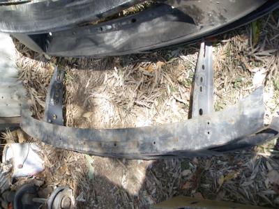

Though im not particularly familiar with the term reo bar could someone tell me what it looks like.

Pic of reo bar
http://www.nissansilvia.com/forums/uploads...71619_thumb.jpg
Mounts to the chassis, in front of the aircon, and behind the front bumper...it sevres as a mounting point for the bumper, resting point for the headlights and grill, and as protection in a crash (hence why cutting it is a stupid idea, not just for the sake of a 7000hp rated intercooler on a stock standard skyline, but for your own safety)
