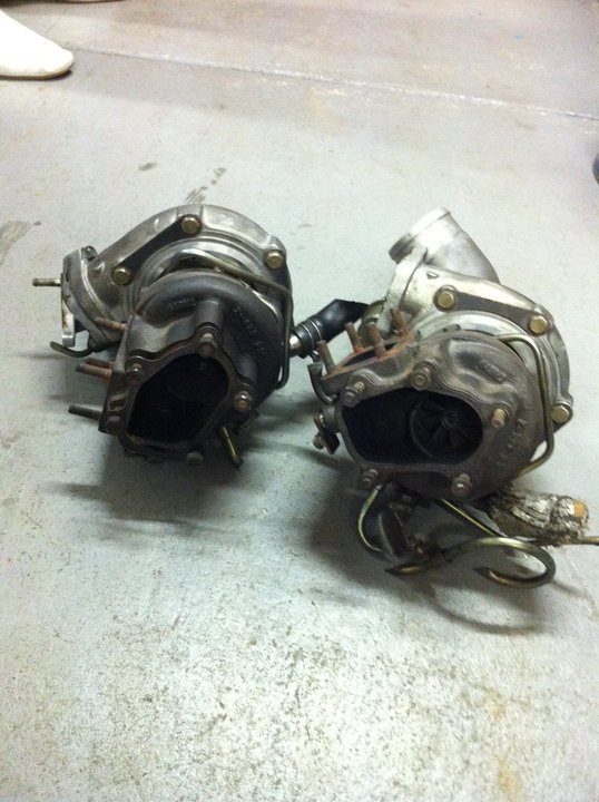

Wow yeah ok. Given how specific you are about your car, I'm very surprised you are happy to do that. As a bare minimum, without having a wideband gauge in the car or running it up on the dyno to check mixtures, there is no way I'd do that to my car. You beat me to it, was going to say just this. -
Yeah - that's not true. Larger turbos flow more at the same boost. By definition. I've always found it funny when the claim of same flow same power because same boost is made. The turbine is larger, therefore will put up a lower restriction to flow at any given flow, cf the stock one. Hence, you need less boost to make the same flow through the whole system. Hence, when you have the same boost as before, you must have more flow. -5s are a pretty decent bit bigger than stock.
That's basically how I've been driving my R33 for a while now. GTIII-SS running wastegate boost. It makes no more power than stock because the turbos aren't flowing any more air than stock. Eventually though I need to fix this so it can actually drive as it should. -
If this was my own car, I would pull about 5 degrees off the CAS, run a wideband, and if that seems ok, send it.
