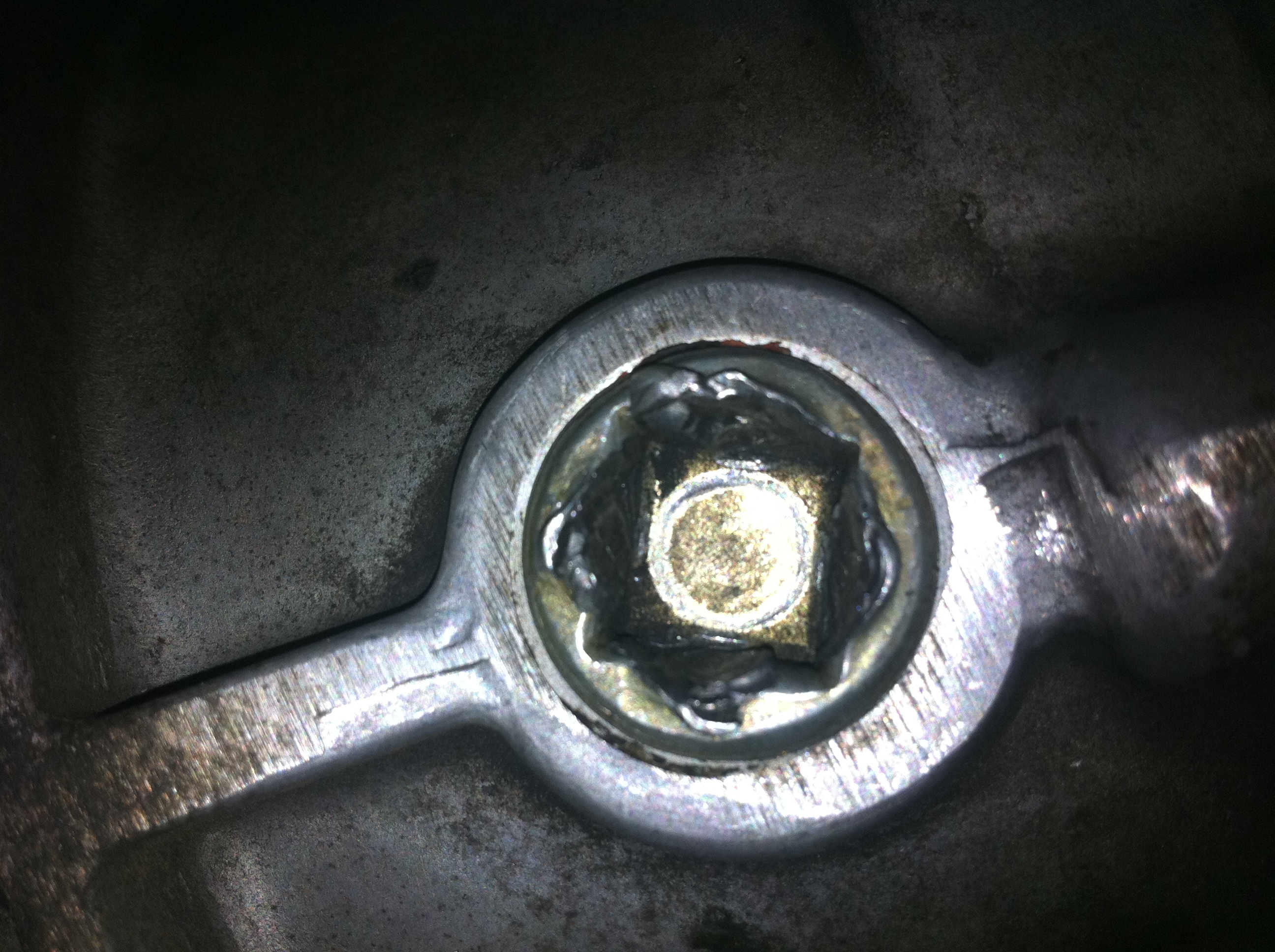

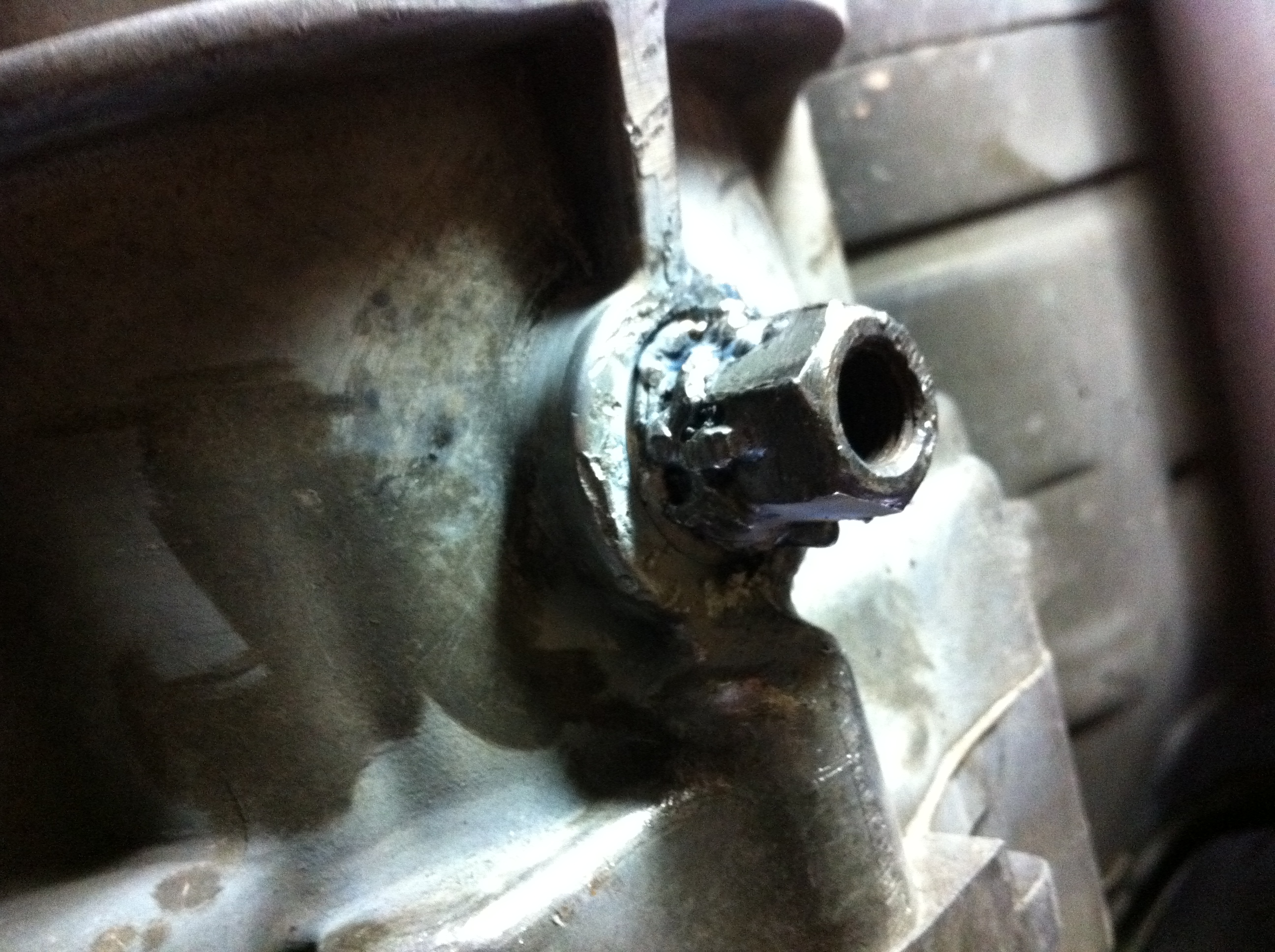

This has probably been covered before but thought I'd share my experience with removing the gearbox drain plug.Been trying to change the gearbox oil for the past month or so and just couldn't get the drain plug to budge no matter what I did! (my fault as I tightened it up too much last time I changed the oil lol) ended up getting a brand new plug from nissan ($27) as the old one was chewed out pretty good since the size of it is a 13mm drive and I was using a 1/4 inch drive which is just a fraction too small (12.7mm). Got my mate to come out today with his welder and he welded on a wheel nut from a commodore and it came off with almost no effort! So if your having trouble removing the plug don't do what I did and chew out the plug lol buy the proper size tool. Hope this will help some people out in the future :)post-52764-0-23539500-1318668474_thumb.jpgpost-52764-0-40909400-1318668544_thumb.jpg
