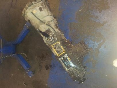

Replacing the clucth in my GTR 33 as we speak...

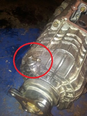

And there was a little oil around the gearbox. When i let it down these two breathers were not connected to anything? (in pics)
Is this right? There both on top of the gearbox.
Any help?
https://www.sau.com.au/forums/topic/416934-r33-gtr-gearbox-breathers/
The one on the gearbox itself is supposed to extend up to a little bracket at the top bellhousing bolt. It is nearly that long now, so will work, but could flail around a little and perhaps leak.
I'm not sure where the one on the transfer case is supposed to have a hose running to on the GTR boxes. But it is fair to guess that it used to just be a short length located up under the tunnel or somewhere similar. Just to give it some breathing room without leaking. You could put a hose on it and take the hose up parallel to the gearbox breather and cable tie them together.
On the GTR two hoses run up the bracket you're referring too, which has two metal pipes both with the 180 bend at the top.
