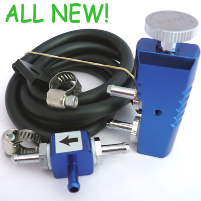

I'd had purchased one of these about 8 months ago:
http://e4eonline.com/VUL_MOT/NEW_BC/KIT_400.jpg
You seem to be missing the Tee from your install (by the way the controller is setup in the pic).

Check out the first link I put up. You'll see a small 3 way Tee. That has the ball & spring 'in built'. The ball & spring are on the wastegate side of the Tee (hence the arrow indicating the direction of boost pressure travel). The controller is essentially a gate that bleeds a pre-determined (by how much the adjuster is turned) amount of boost off, BEFORE boost pressure overcomes spring tension & the ball lifts off it's seat to allow pressure to the wastegate.
If you do not have the Tee fitted, it ain't going to work (as per OP picture).
The boost TEE is missing from the picture. I dont know if you can get those controllers with the ball 'in built' with the gate, I doubt it.
The manual set up I bought came with a note, telling me to ignore the arrow, as It had been incorrectly printed. Quality.
A quick blow into the Tee will tell you which way to install it.

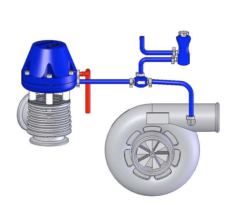

So i found this diagram http://i79.photobucket.com/albums/j141/rustyshackleferd/boostcontroller.jpg
and installed it exactly like that and took it for a spin and it boosted to 20 psi straight away with controller only on half a turn so i just put it all back to stock again check all the hoses and clamps trimmed a bit off the worn hoses to make sure theres no leaks went for a drive and it is still hitting 10 psi so if its not doing any harm im pretty happy just to leave it how it is but really want to know why its at 10psi unless i connected a hose up wrong?
ROFL! Yeah, they are a bitch!!!!
Remember Trial & Error.
OK, as for the 10psi, it's most likely a hose/fitting issue. Worst case, maybe the wastegate diaphragm wasn't happy with it.
I'd recommend sussing out the cause, just so you know in case of any further arising issues.
or start step by step elimination. run hose straight from intercooler piping to wastegate., see what minimum boost is there. a r32 actuator will give you about 10psi so maybe you have that installed? or maybe the one you have is faulty, have seen one on a r33 (should be about 5psi) running at 9psi...
