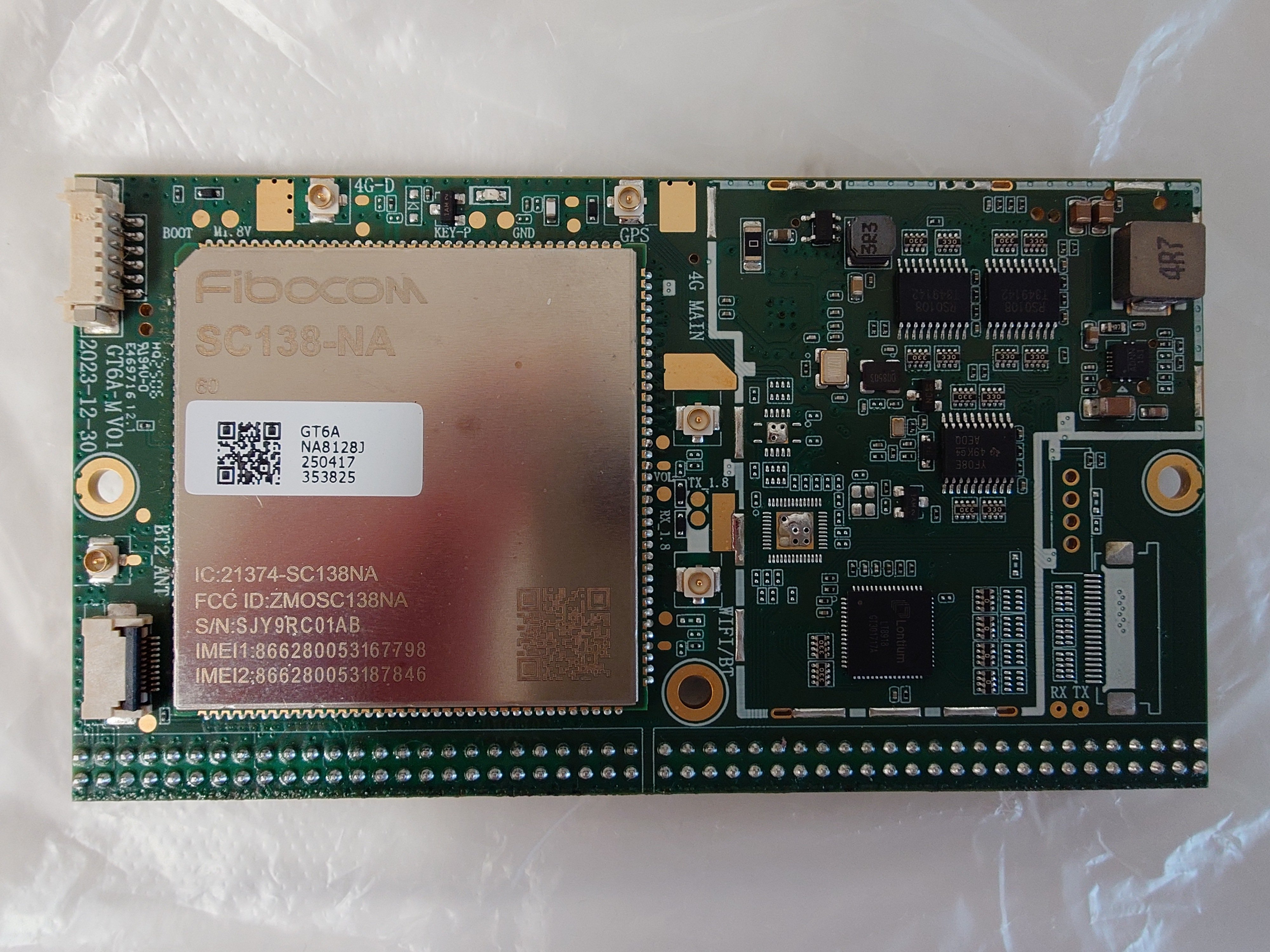

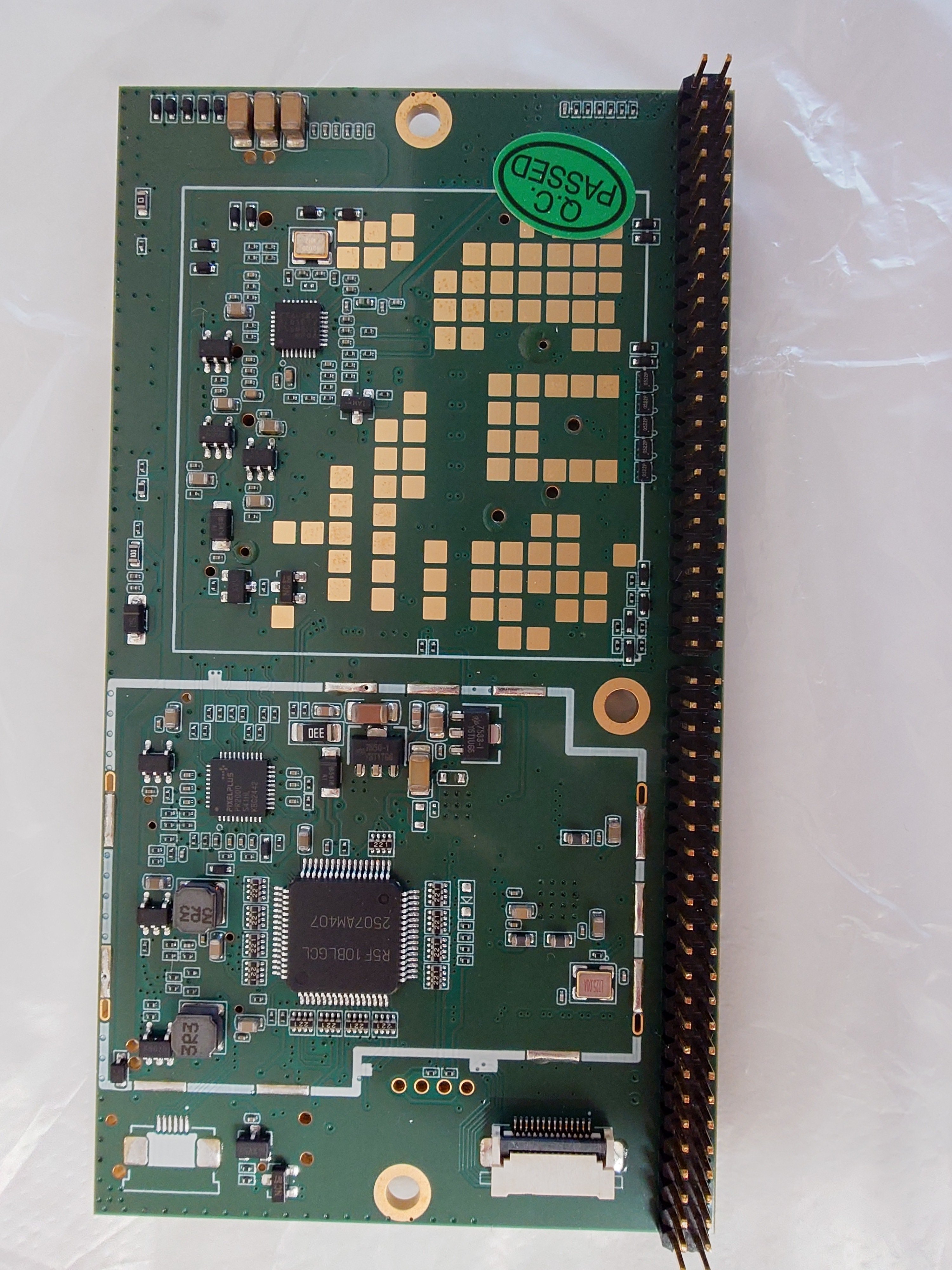

That is a right pain, but much better than having a dead forever unit, good on them for helping (sort of) instead of ignoring.
Most likely internal connections will be like a laptop/consumer electronics. Tiny white plug/socket connectors, sets of pins joining mother/daughter boards and ribbon cables for any display connectors into those long plastic housing that flip up (I can see at least 2 of those in the pics).
If you are not familiar with them, there would be youtube on all of them, nothing is hard just need to know the tricks
