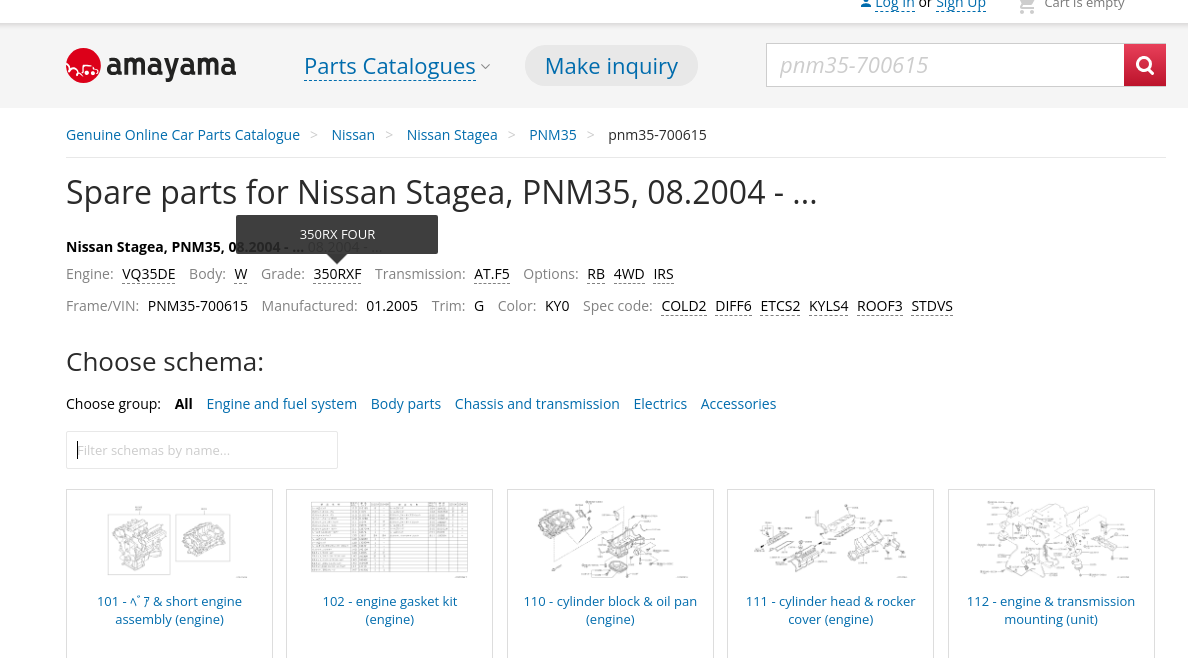

Hi All, putting the engine back together and everything is perfect except have this plug left over.. any ideas what it is for and where it goes? Is on cold side under the intake plenum *note not a stock plug, as everything has been modified Cheers
