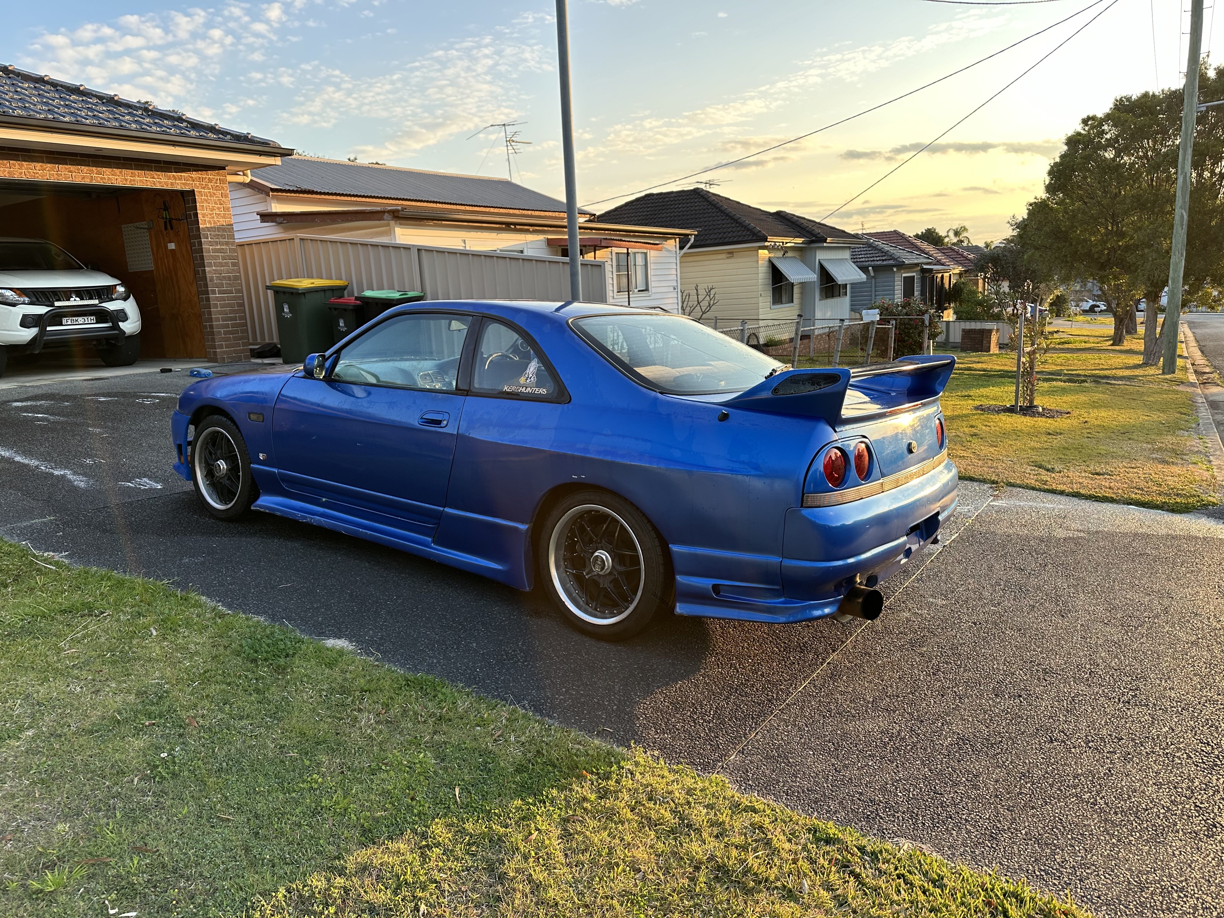

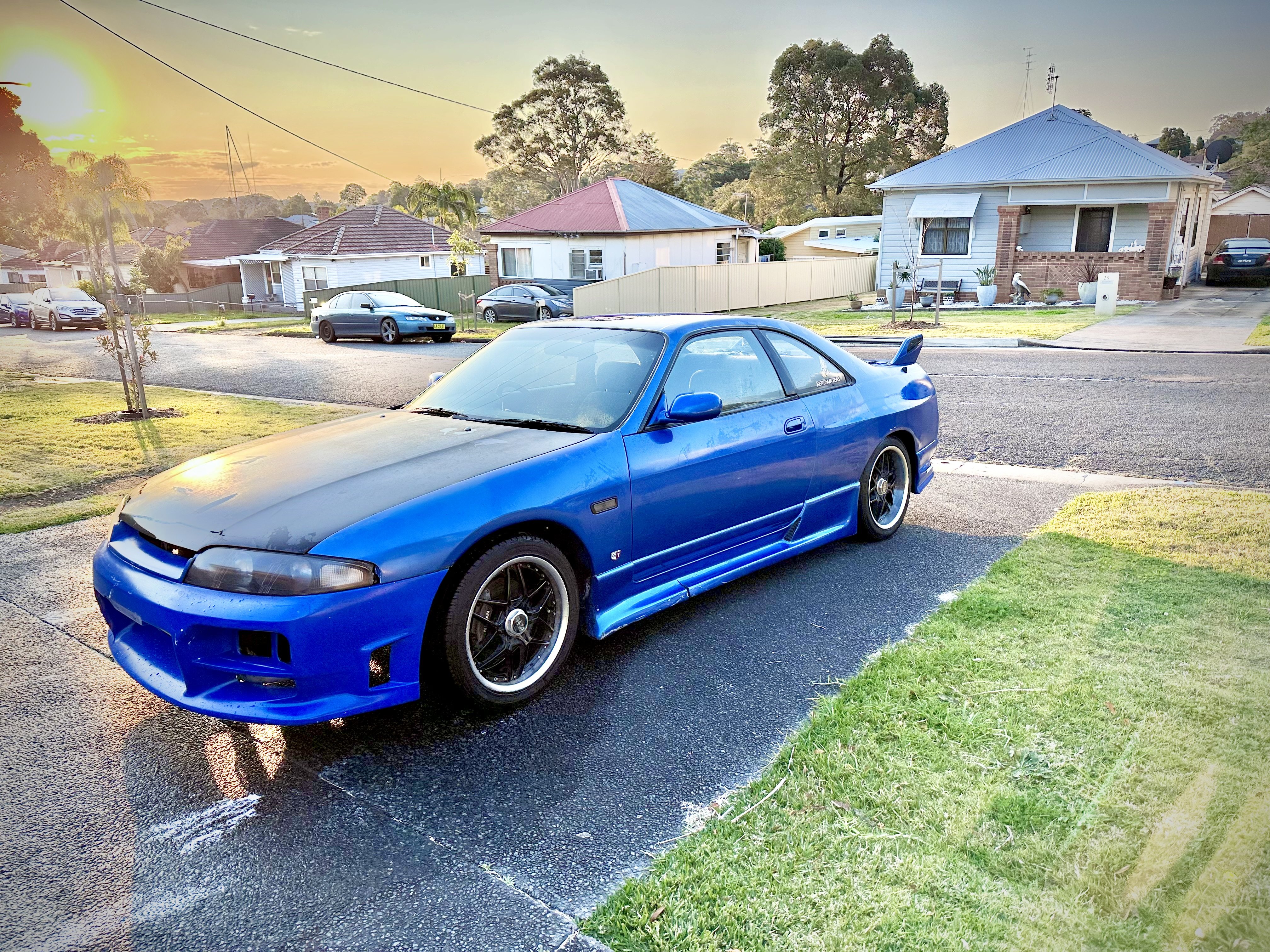

Fast forward to the present day, I’m in a much better position financially and daily an MQ Triton (great cars, pipe down Ranger Bois), I cruised marketplace and car sales for a few months looking for another R32, the best deal I could find was an absolute rust bucket half finished project for $12000, until this R33 popped up in Port Macquarie for $18k - unregistered and barely running but decent shape, kept an eye on it for a few weeks and the price steadily dropped, $16k then $15k then $14k, that was the point where I was like shit someone’s gonna snatch this up! It was owned by a young bloke who had big plans but him and his missus just had a baby so smartest move financially for them but big gain for me.
So 2 days later I’m towing a car trailer to pick this thing up.
Roughly 2 weeks and $3500 later I’m cruising around Newcastle in my beat up R33 all smiles and dose noises! It only needed some basic shit to get it going, coil packs and air flow meter, electrical stuff and all fluids changed, 158k kms and running pretty good, nice smooth engine after oil and coolant flush - when I say coolant I mean it had been filled up with tap water, every gallery and heater element was filled with rust, 8-9 flushes later and still had brown liquid coming out but she’ll be right.

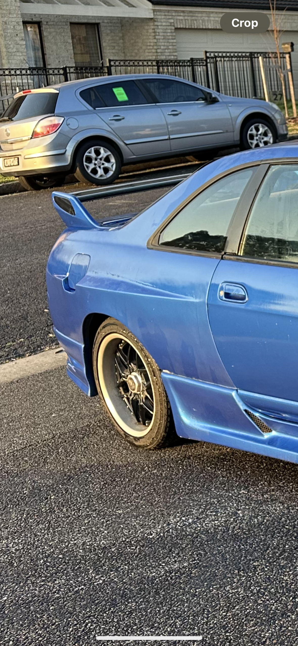

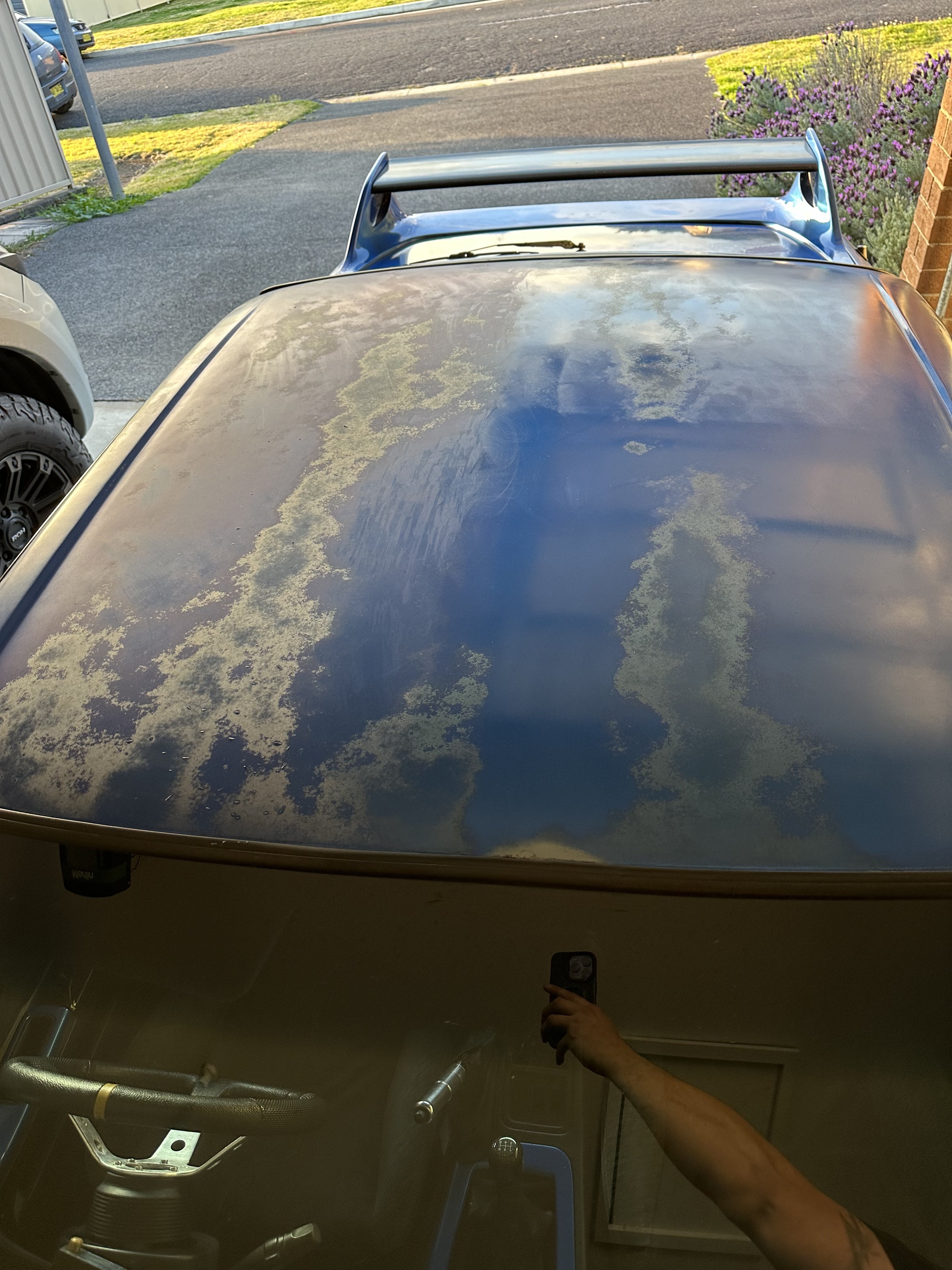

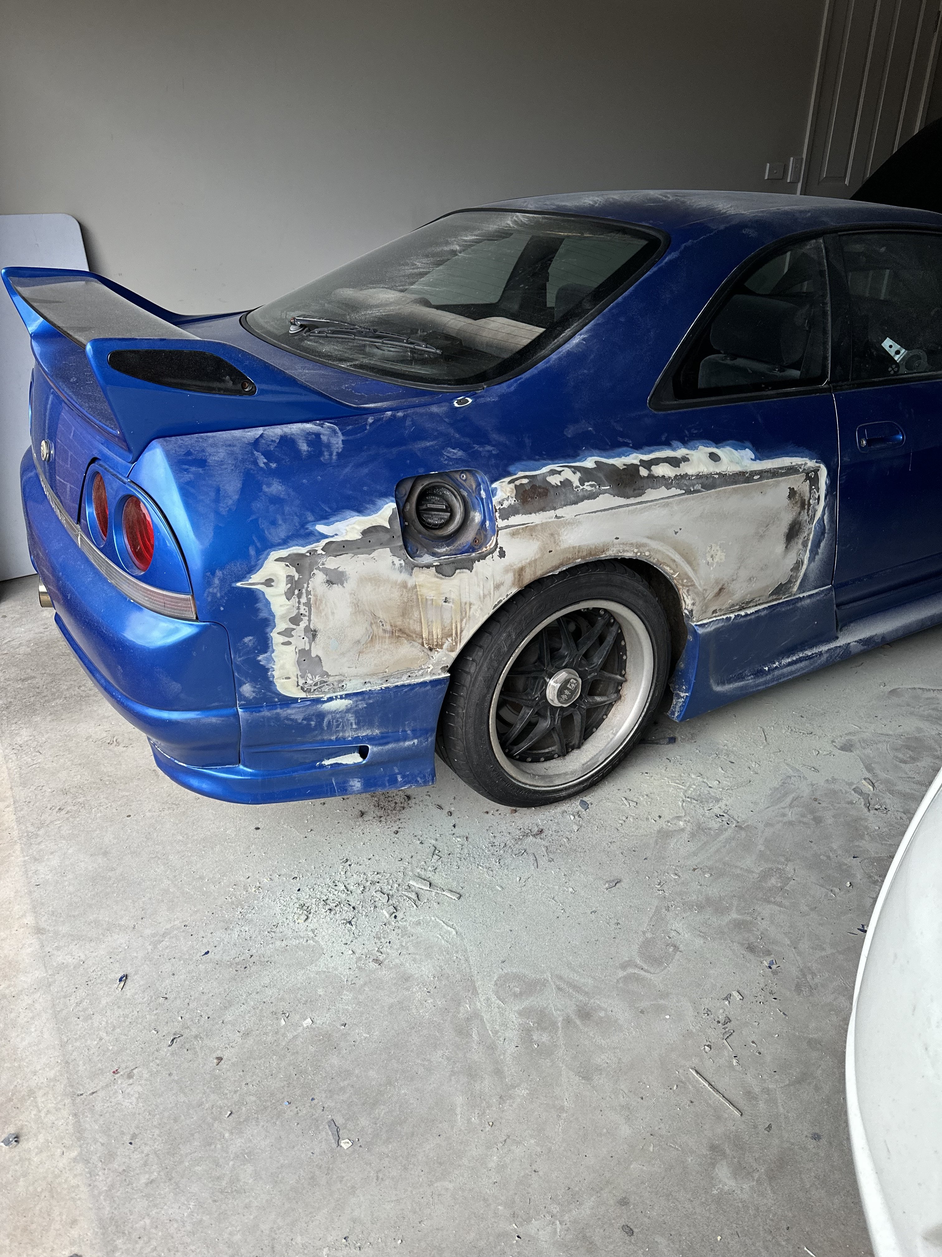

The car was painted R34 Bayside Blue at some point but whether it was a cheap job or just not looked after is anyone’s guess, clear coat flaking like sausage roll.
Was rethinking my choices and contemplating life, had it up for sale for $22k - still cheaper than any registered R33 but got little interest, next minute I had an opportunity at work - 6 months overseas for good money, so that was a no brainer, fast forward again and here we are with a 50% finished project.

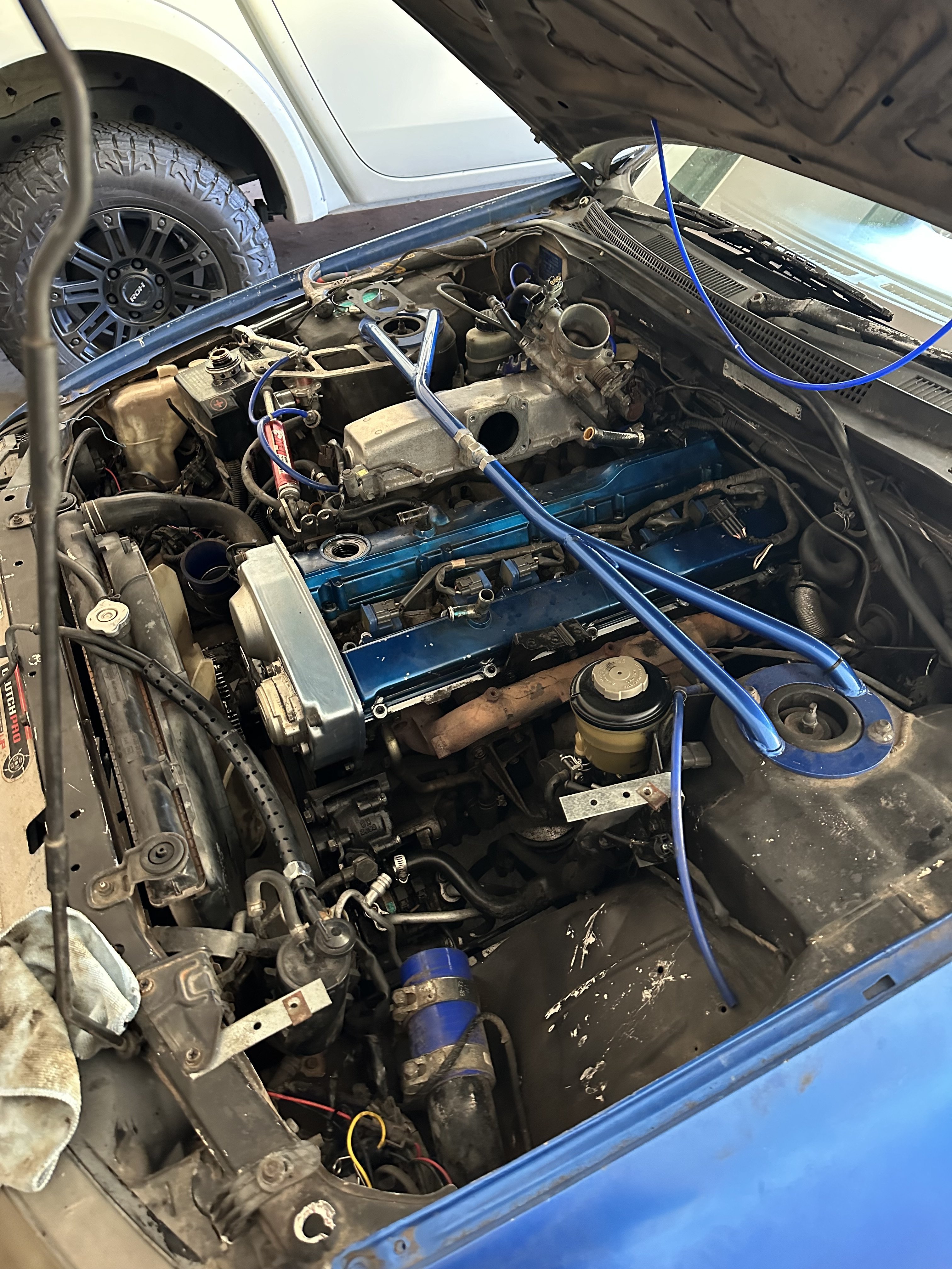

200ish KW according to butt dyno
Was tuned with Apexi PowerFC
EBC (old school Greddy Profec)
Stock turbo (more shaft play than a Tinder date gone right)
3inch turbo back Varex muffler
Aftermarket injectors of mystery size, Power FC showed 36% duty cycle at full boost so not behd good size
Someone had good intentions but stuck with the stock R33 MAF so we had misfires at 6000rpm due to the MAF hitting 5.2V

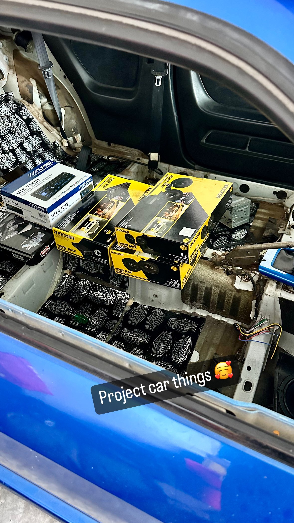

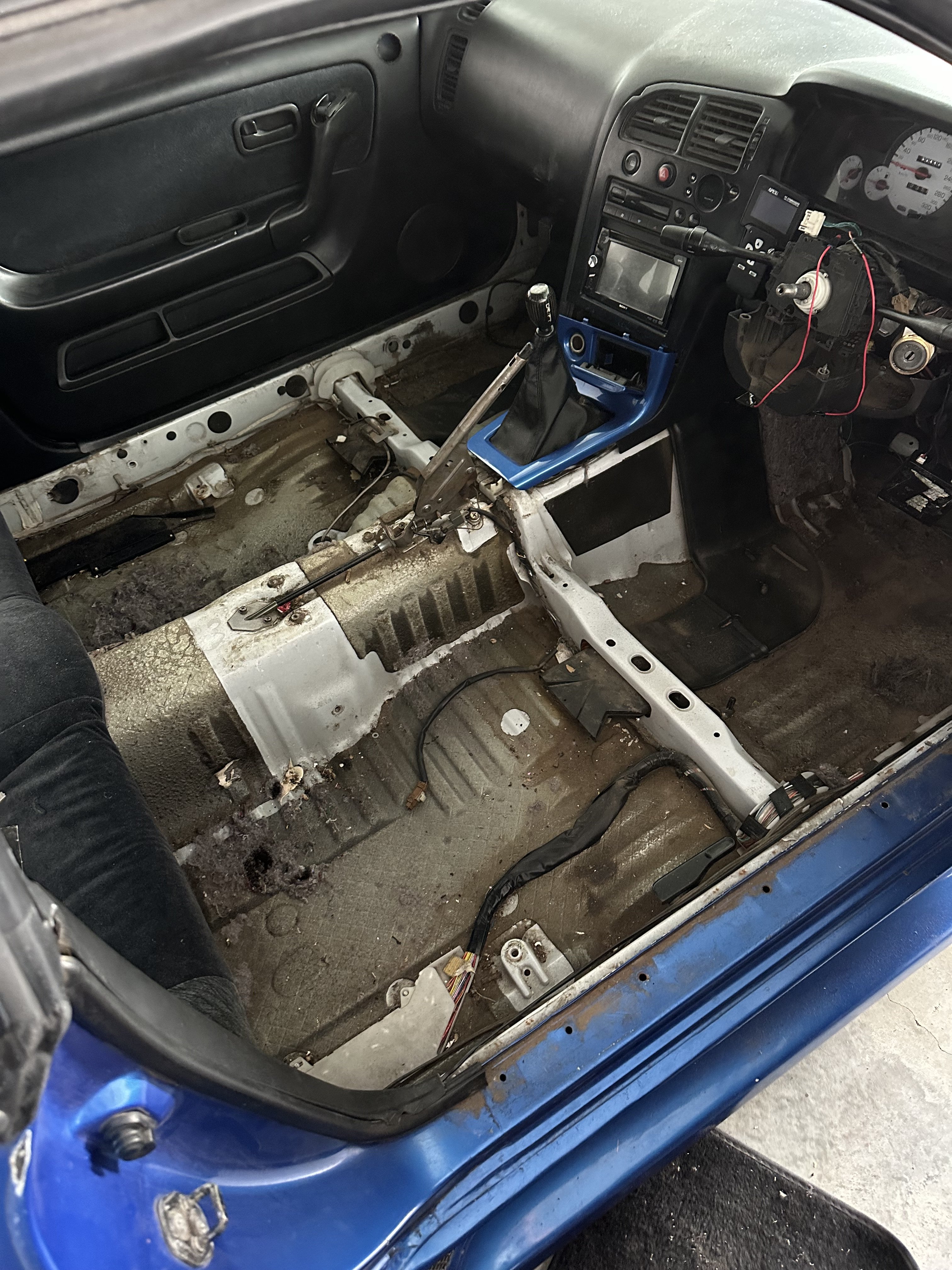

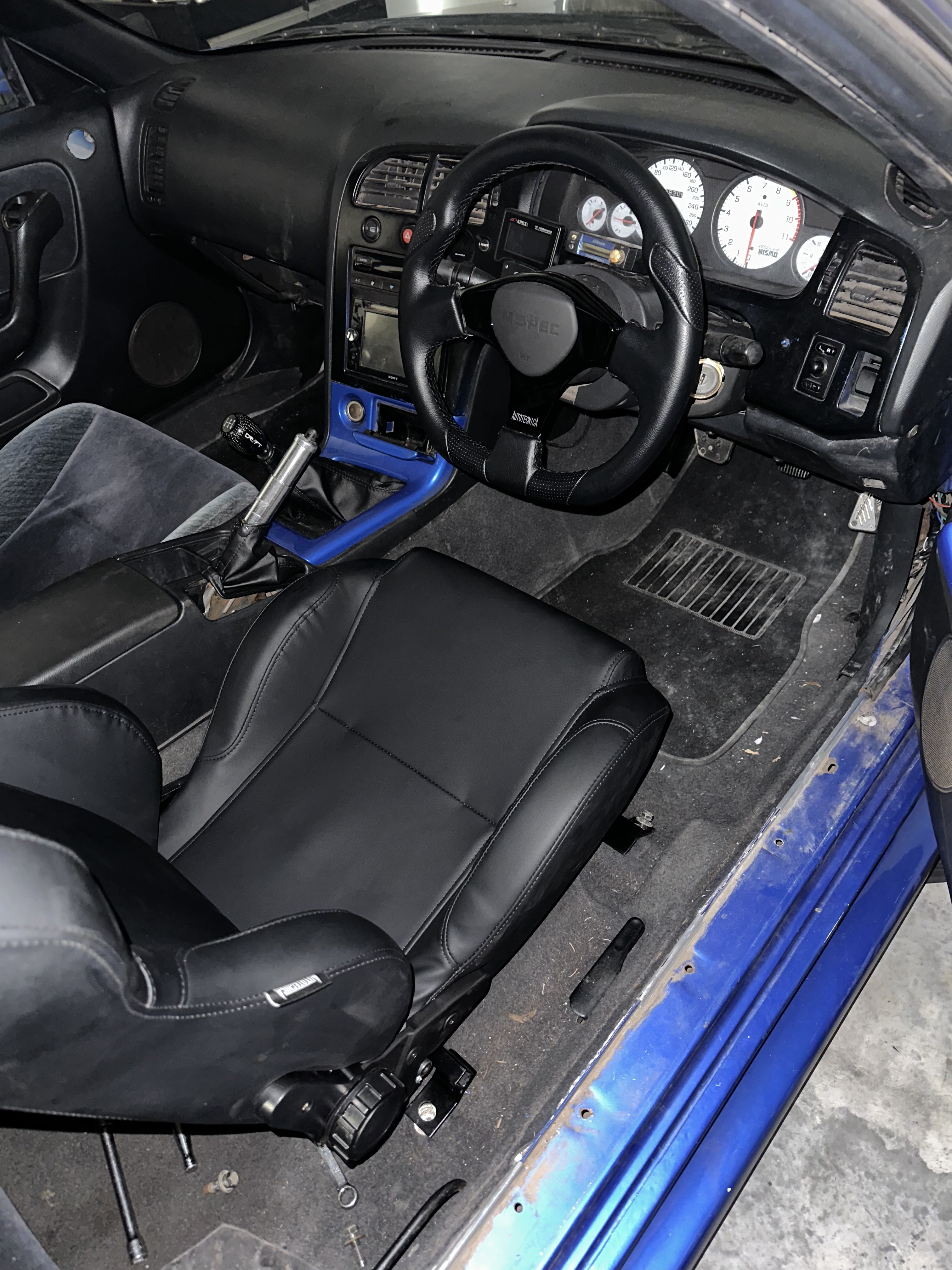

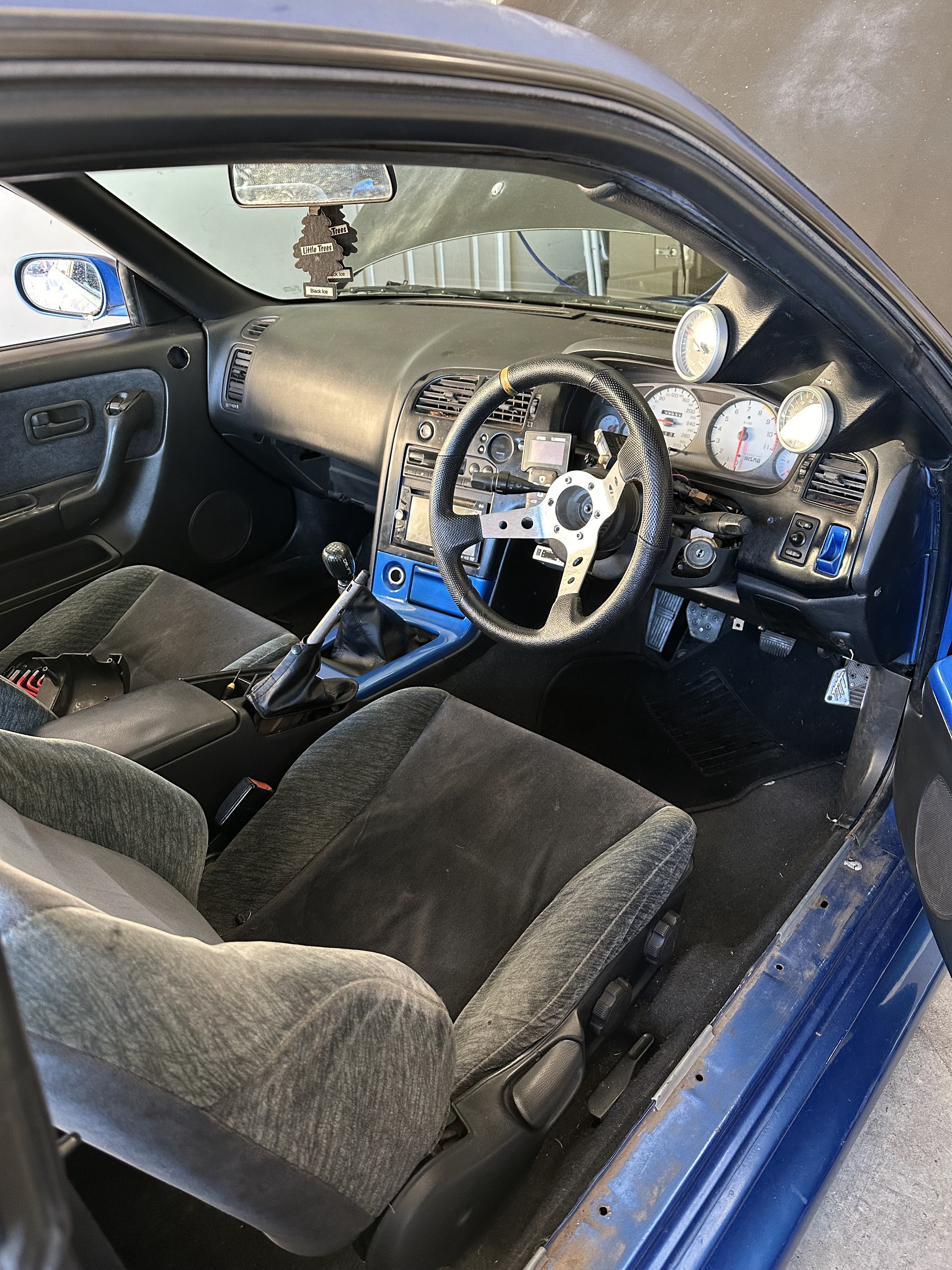

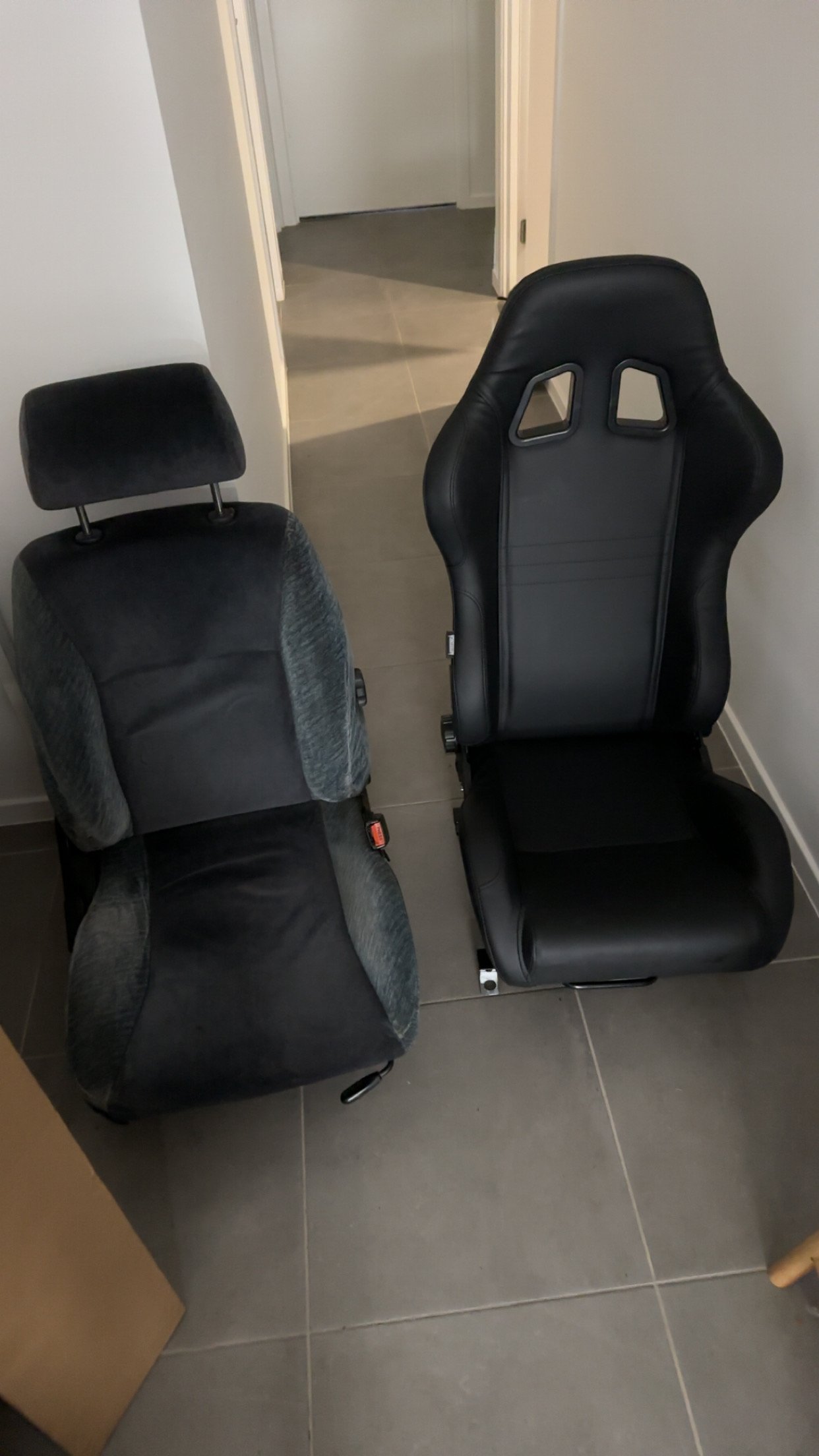

So far I’ve redone the entire interior with carpet form Car Mats Direct, new Seats and steering wheel from Autotechnica, also sound system by Autobarn (mainly Kicker)

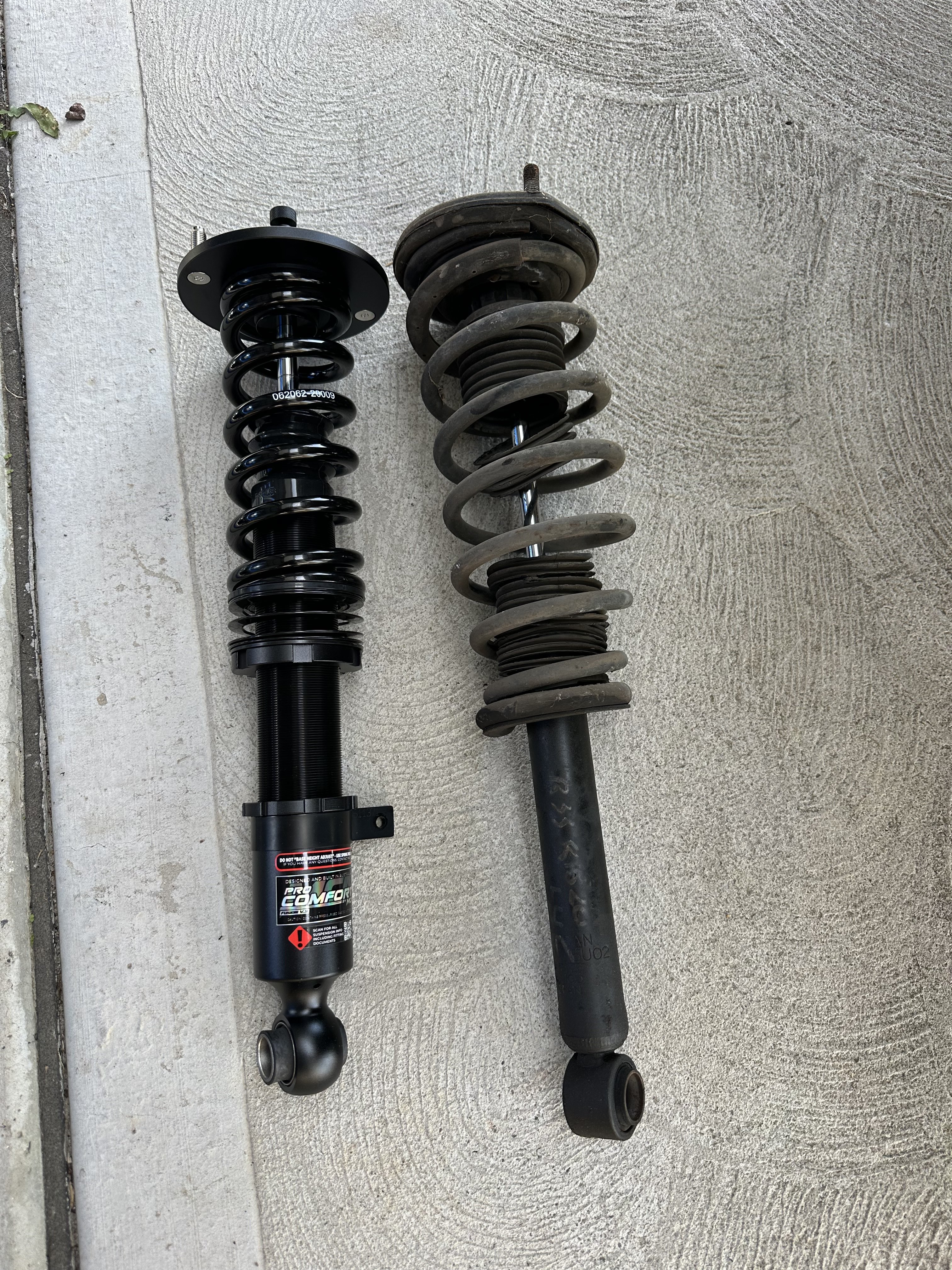

Also MCA pro comfort coil overs - Hands down best purchase yet, worlds of improvement over the tired 30yrold shocks

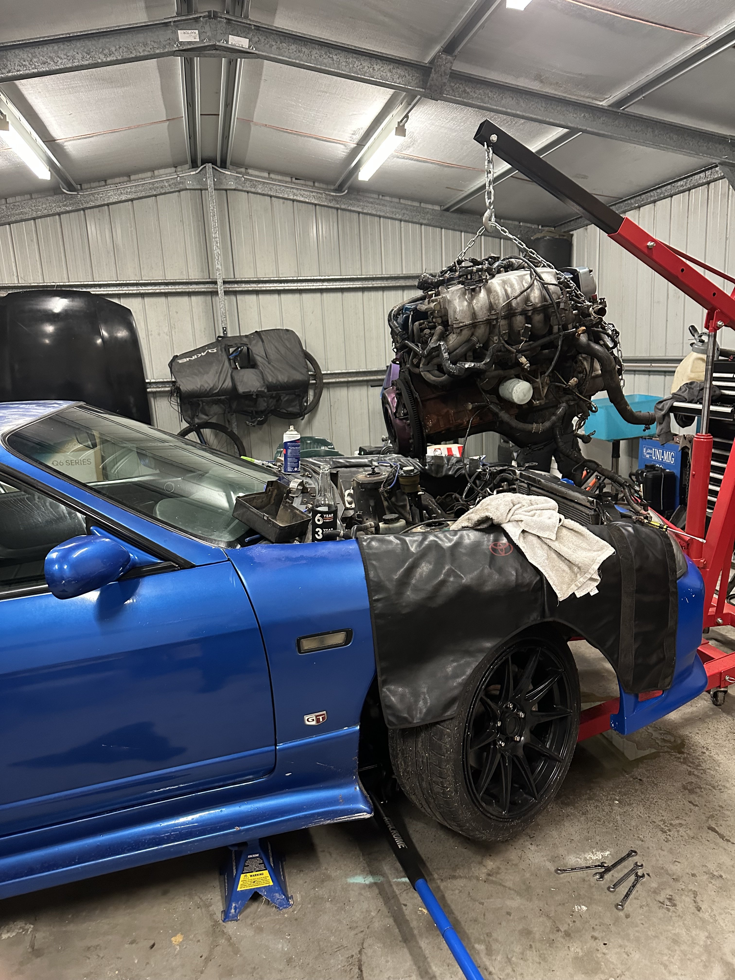

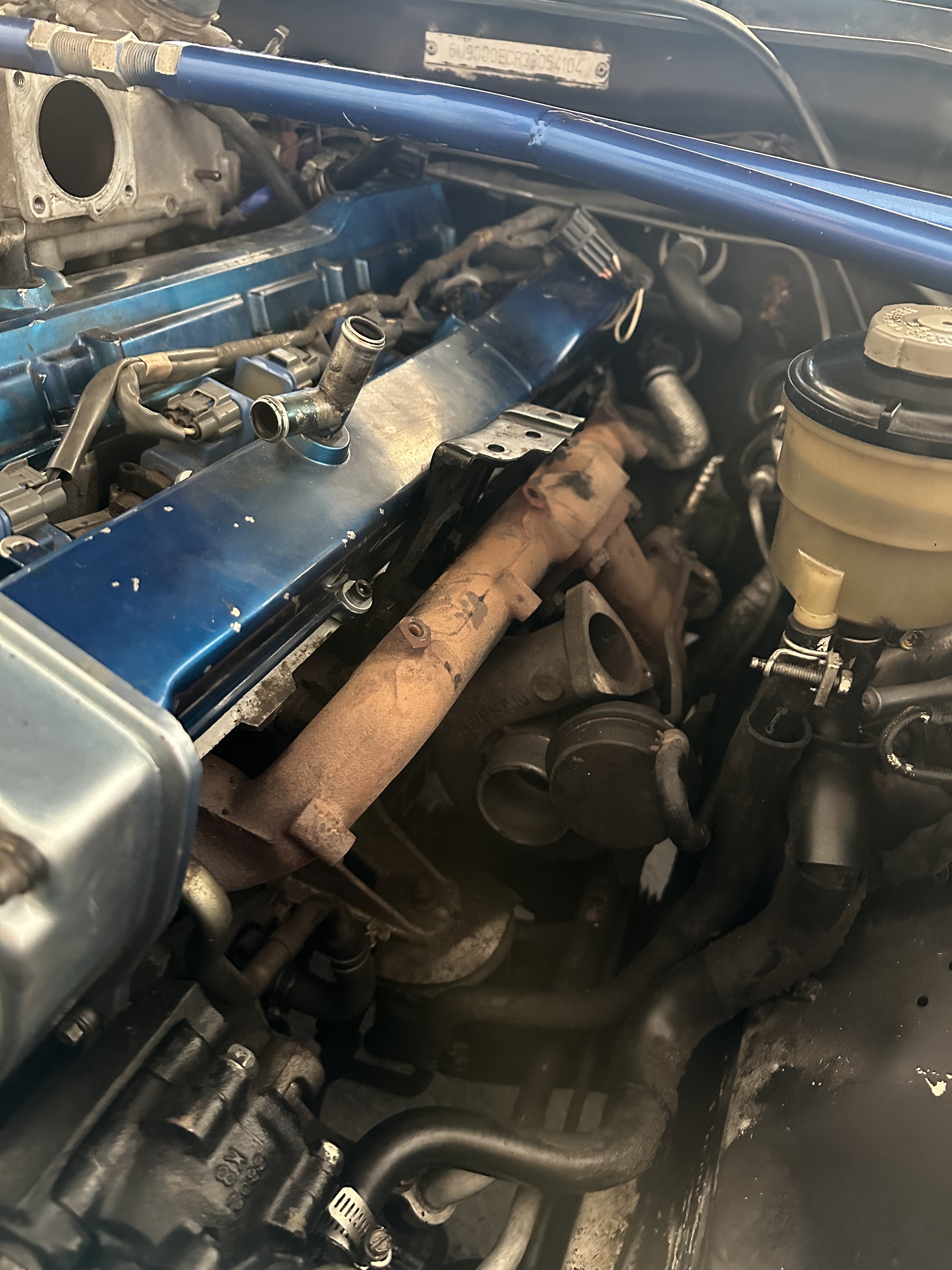

Engine is at the shop getting rebuilt with forged rods a pistons, new valves and springs, ATI Harmonic balancer, Aeroflow 7.5L sump, rear head drain and oil restrictors as per oil control thread* and cam covers modded for larger breathers, other stuff I can’t recall of the top of my head

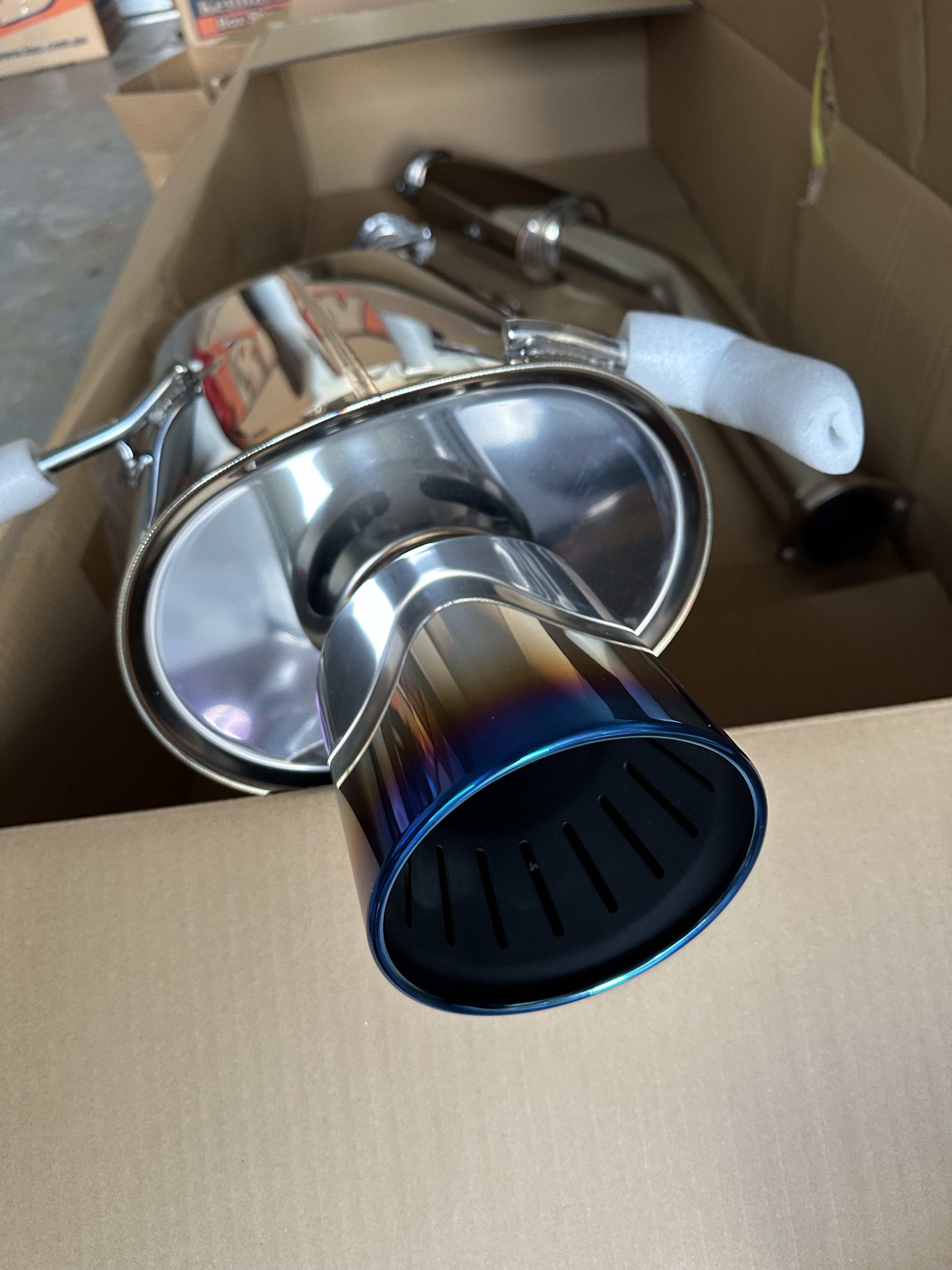

HKS Super Turbo Exhaust with High Flow Cat

    • Some more close up pics now that I’m back to working on the car, the loop pile is nice but again haven’t compared it to the other types in person, it’s hard to tell from the pics on the website. View of the hemming on the edges too, it comes in 2 pieces - front and back, honestly very happy with it for anyone on the fence.  Also attached my previous pics from further up as it didn’t let me post them directly before. (Nothing worse than photo bucket pics that aren’t hosted anymore years later)
