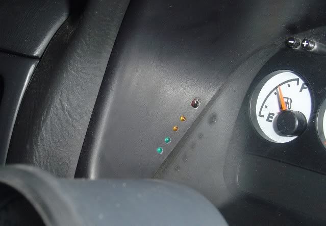

A knocklink is essentially the same thing, but i have found that the powerFC listening range is different to the knocklink in some circumstances.
The knocklink has 5 leds to indicate knock, two green being the smallest, two orange being the middle range and a big red led to indicate there is a real problem.
I find it useful to know when the car has small amounts of knock so i can tune it out, rather than wait for a 50 or 60 reading on the power fc until i know that there is a problem.
When doing a power run, if can see some of the lights in my dash light up when pinging is detected, i can backoff and see what the last section was lit in the map tracer.
I'll take a pic of my setup and post it up.
Knocklinks are about 250 bux from memory and have their own knock sensor.

LED's can be seen very well at night, its a bit hard to see them in the daytime if the sun is directly glaring on them tho.
