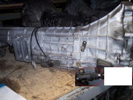

yes, plenty of cheap shitty cars have cable clutches. there is no slave cylinder though. they just have a cable from pedal to fork. but as I said above NO GTR has a cable clutch (neither does any GTST). and after all this is about GTRs, not 1976 model mazda 323s... also cable or hydraulic has nothing to do with any difference between push and pull type clutches.
That would be right.. strange that you say you have a pull clutch in a 90 gtr.. will be interesting to see what gearbox and clutch you have now, when you pull it out.
Do you have the ability to remove the gearbox, inspect the clutch, and then order the new parts? That way you would be sure of what you needed.
Nothing worse than ordering the wrong parts.
