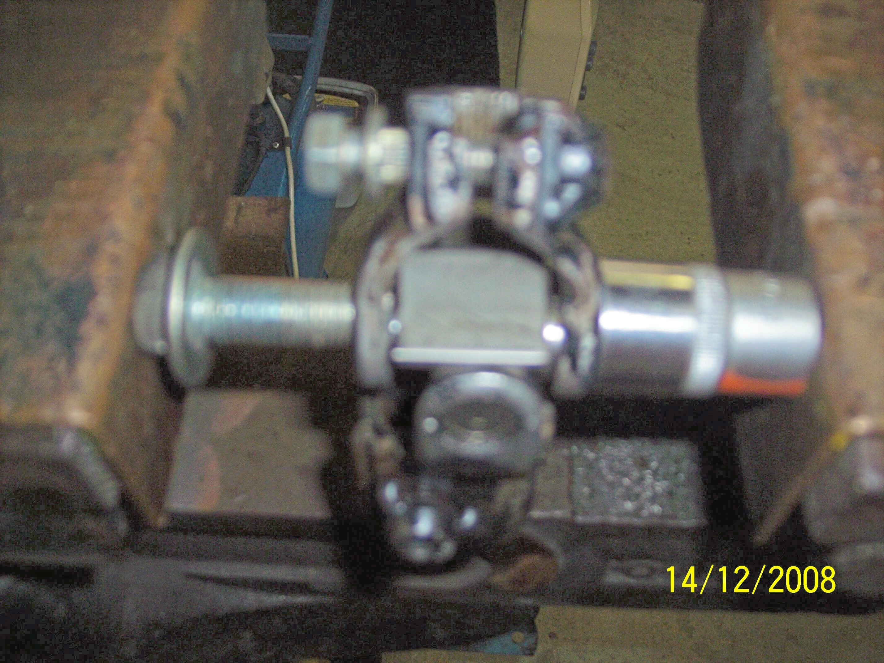

post-25786-1230975638_thumb.jpgpost-25786-1230975912_thumb.jpg Cost about $35.00
To fix
Undo the two bolts holding it on. Slide it up first to get it off the rack then pull it down. You may need to spread it slightly with a screwdriver but don’t get to aggressive.
Using a bolt and a socket in the vice (see photo) it is quite easy to push the old unit out. But be sure to put a piece of metal between the fingers of the universal (If these get bent it’s all over red rover) so as not to push them together. I used a piece of 3mm plate about 30mm long and about 25mm wide.
To install the new one you will need to take the caps off the star so you can insert it in to the fork then it is back to the vice.
It’s a little tricky at this point and it is easier if there is an extra pair of hands to hold everything while you do up the vice (Again with the piece of metal between the forks). Push the cups in far enough so the seals do their job. The cups should be about 1.5/2 mm below the surface. Give it a light tap with a centre pop punch and it should be as good as new.

Using a bolt and a socket in the vice (see photo) it is quite easy to push the old unit out. But be sure to put a piece of metal between the fingers of the universal (If these get bent it's all over red rover) so as not to push them together. I used a piece of 3mm plate about 30mm long and about 25mm wide.
It's a little tricky at this point and it is easier if there is an extra pair of hands to hold everything while you do up the vice (Again with the piece of metal between the forks). Push the cups in far enough so the seals do their job. The cups should be about 1.5/2 mm below the surface. Give it a light tap with a centre pop punch and it should be as good as new.

There was no noise or sloppiness at all. The only other noticeable thing was the colder it was IE first thing in the morning it would be more noticeable. It’s the two cups across one plane of the star that causes this feeling.
