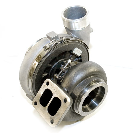

And a twin scroll T4 turbine housing as I haven't quite been able to ascertain from your posts if you know exactly what it means:
So the pulses from the two sets of cylinders are kept completely separate until they hit the turbine wheel :)
