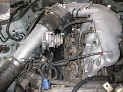

they want a picture? what for? its on top of the motor and looks like a factory BOV. i bet its NA, thats why they cant find it hahah
Nah, I bet they want to see if they have another BOV lying around so they dont have to part out the M35 :P
https://www.sau.com.au/forums/topic/350632-m35-stock-bov/#findComment-5631375
Dont all bov's look the same?
They certainly don't work the same. M35 runs 1 bar stock so needs a strong spring, it also has a bypass hole to bleed a little back to the compressor and stop the surge you would get normally with the stronger spring. I blocked the 4mm bleed hole and it surged badly on part throttle after backing off.
