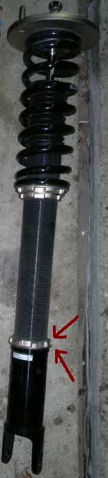

I purchased a set of BC racing BR SR coilovers last week from a member on this forum, they are 6 months old & supposedly have done less than a tank of petrol worth of driving.
I fitted them on Saturday & took it for a test drive to find a rather solid knock coming from the left rear, only when i went over a substantial bump at any speed, thinking maybe i have fitted them incorrectly I swapped the 2 rear coilovers around (left to right) & took it for another test run & now the knock is on the right rear so Its definitely the coilover thats stuffed :rant:
I checked the nut at the top & its tight, there is preload on the spring not sure how many millimetres but i can still turn the spring & no leaking issues. does anyone know what it could be? maybe the top mount? they are rubber not pillowball.
:thanks: in advance

sheesh with that much threaded body you think they would spec a longer coil (10").
Yep, check the collars. Btw. Don't compress the rubber much at the top nut - you just do it up until just past touching (I also add some lock-tite, the type that doesn't fully cure).
