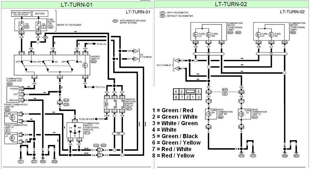

SO, found this wiring diag on the net, comes from a 2002 Nissan Centra - has 8 pins like the stag one so hopefully it is similar.
Question is - Where can I put a switch to affect only the hazards?
I feel more explaination may be due so fire away.
Diag attached is NOT for stagea and more for my reference, pinouts are incorrect colours too.

I can't remeber what the stagea hazard switch is like, I did figure it out when I put my alarm in but that was a while ago.
Going off that diagram (I saw it's not a stagea one) but you would interrupt pin 4 on the hazard switch, the wire labeled "W". It would have to be done at the switch so as not to interfere with the normal turn signals.

give me a minute and i'll do a quick paint diagram of the hazard wiring.
edit: the diagram. so it basically the same as the one you found. i was wrong in saying that Pin 4 on your diagram would do it, i didn't realise that both left and right indicators would be linked with the button pushed on, so when ever you turned on an indicator both would flash confused.gif
if we remove the flasher signal and indicator lines from the switch (pins 1, 7, 8 on my diagram) and emulate that on an external switch you will get what you are after, though as a said before, indicators will still work when ignition is off, or hazards will only work when ignition is on depending on if you leave the hazard button in the on or off position, unless you throw another relay in the mix.

just knocked this up for you. basically you just use a normal switch, the one you already have should be good enough i guess. then just use 3 automotive relays, just the black box bosch one. there will be one wire left over on the hazard switch, a red wire with blue trace, that is just an illumination wire for the globe in the original hazard switch.
