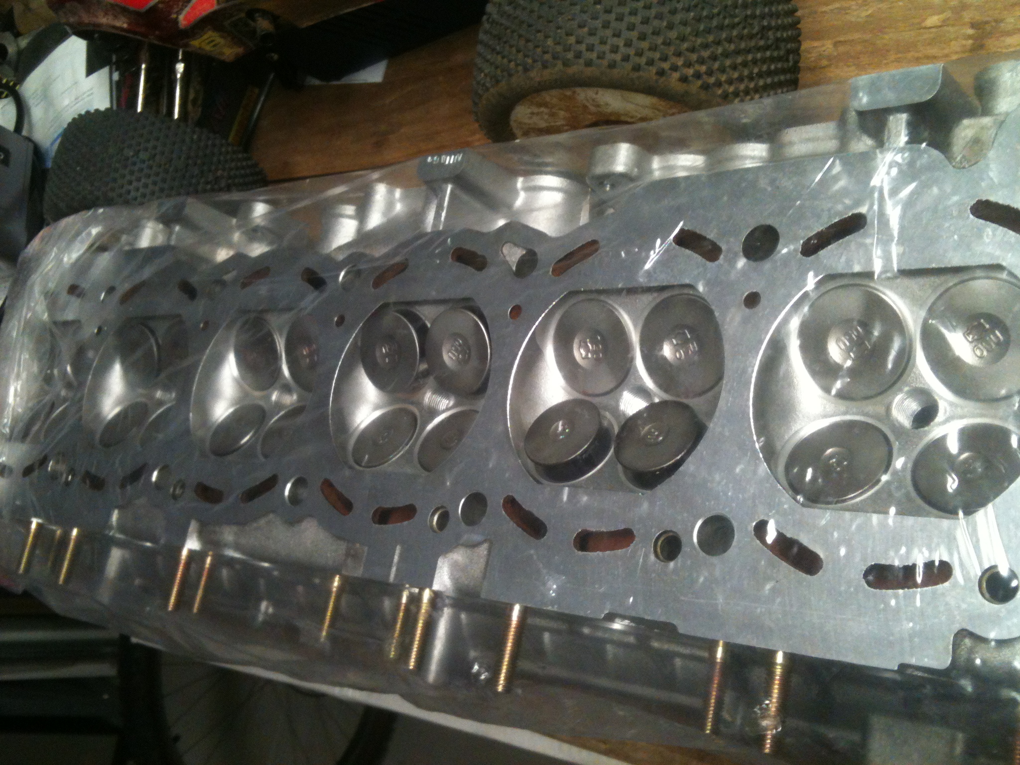

First of all i'll tell you a bit about my build.
I have a Autech HR31 Skyline setup for drift.
And now have come to the end of the build regarding engine and head wise, and am seeking assistance on which computer i should choose to run this setup.
It is a R33 RB26 head and RB30 block.
i'm thinking D-Jetro, but a bit lost as to what to choose.
Any advice much appreciated.
Also i need a loom???
https://www.sau.com.au/forums/topic/383580-computer-advice-for-r33-gtr/
Talk to your tuner and ask them.
this. no point walking into the workshop you want to tune it and handing them an ecu they've never seen before. if you plan on having a certain workshop do the tune then use the one they recommend. even if it isn't the best ecu on the market, having them tune something they know will give better results than getting them to tune an ecu with all the bells and whistles that don't end up getting used because either they don't know that it has them, or they simply can't set them up properly.
Yes you could do that, but no doubt any good quality ECU is tuned by a quality workshop.
Its cool now, i have been out of the scene for a while and contacted my engine builder, funny enough is the distributor for the ViPec V88 so thats what i'll be running.
but cheers for the input.
