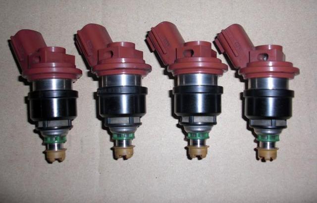

Alright here are the injectors.
They say a46-00 on them, the otherside is hard to mark out, looks like 0f69936
Cant make what of the injectors. The car runs rich as f**k, barely idles, billows black smoke out the back.

The money is on them being SR S15 480cc injectors, minus the pintle caps (where the heck are they!!!?). Also looks like where the injector should be silver, has been painted black.
Here's what they look like: http://1.bp.blogspot.com/_7y7I_iLm7Y0/S9aVoMAwDvI/AAAAAAAAAWk/UhJ6MCUuzY8/s1600/USED+S15+INJECTOR+480CC+NEAR+NEW.jpg
You might not even have highflowed injectors even, just regular 480cc's.
Well i took injectors 1 and 6 to the fuel shop.
They were the easiest ones to remove quickly whilst the rail still being attached.
Results, injector 1 flows at 758cc per minute and injector 6 at 754cc per minute.
So at this stage, Im just going to assume the other 4 are with in those margins.
No idea what injectors they are but they flow exactly how it was advertised, a little more even.
I guess if they aren't nismo's they are high flows? Possibly a high flowed S15 one?
