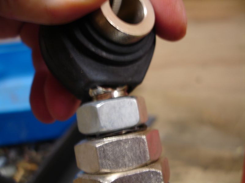

Have a look at the rose joints and make sure they are single piece joints not just sypherical bearings with thread welded to them like some of the chinese crap ive seen.
Yeah had a look and they all seem ok' date=' blurry photo...
