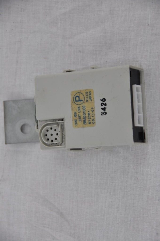

Today I opened it all up and did not find the solenoid stuck (See photo (with hook)) so I simply unscrewed it from the mechanism and taped it aside. Now it never locks - it can't. So I made the assumption that this particular solenoid must be broken and I should go buy a replacement. I'll try to buy both solenoid (3470 Select lock - Shift lock) & switch (34980 Switch Assembly - Park Position) - This seemed the most appropriate way forward. However, whilst search through E-Bay tonight I came across a Shift Lock (2854001U02) and I'm trying to understand where this fits in and the likely hood that this item may also be part of the problem. Where is it located?

The shift lock is the control box and beeper. It sits above your left knee/shin.
