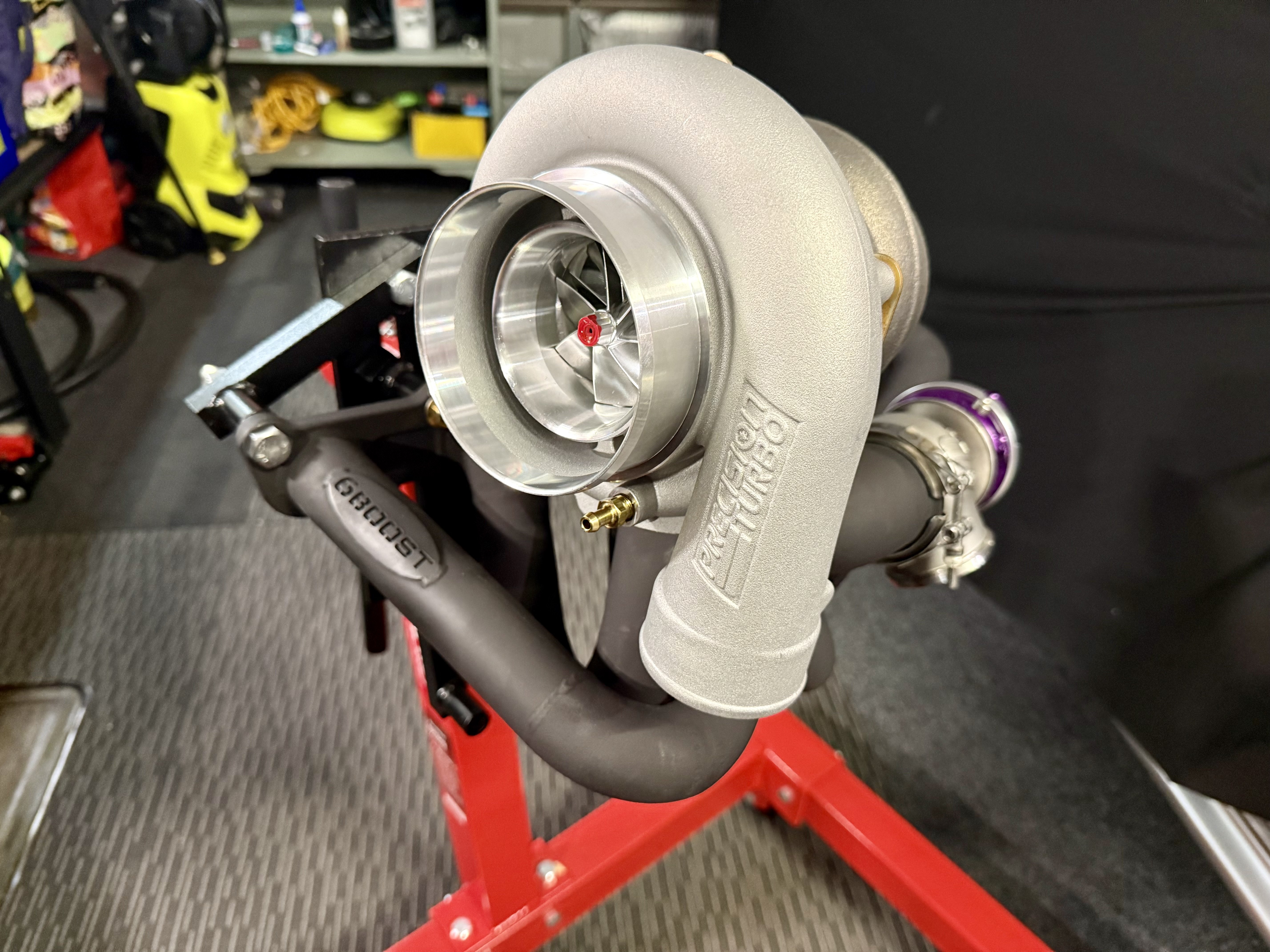

Hi everyone, I'm about to complete my first single turbo conversion on my R32 GTR and I thought I would post the step by steps that I will be following. I will list the parts I have / the parts I will be buying. I will be redoing this guide after I have completed the conversion.
Parts list:
- 3576 turbo 0.82 v-band (coolant and oil)
- v-band top mount turbo manifold
- 50mm wastegate
- manifold copper gasket
- titanium manifold stud kit
- turbosmart 3 port boost solenoid
- link can lambda kit (wideband)
- link ECU
- radium 12AN push in valve cover fittings (pair)
- hi octane catch can
- 3.5inch downpipe
- screamer pipe
- pipe from turbo to intercooler
- intake pipe setup
- power steering relocation kit
- oil drain block off plate
- coolant and oil lines
Now onto the step by step guide (please add / correct me if there's anything I missed:
1. remove fluids, twin turbo pipes, pod filters and afm's
2. remove the factory coolant hardlines from the hot side.
3. remove heat shields
4. remove the downpipe
5. remove turbos and manifolds
6. remove factory manifold studs
7. clean whatever mess you have made
8. install power steering relocation kit
9. install new manifold studs
10. install new turbo manifold with gasket
11. install new wastegate with screamer pipe
12. install new turbo
13. install new coolant and oil lines
14. install rear oil drain block off plate
15. stop and appreciate that you now have a single turbo in your GTR
16. wipe away tears of joy and install downpipe
17. install the wideband sensor into downpipe
18.install pipe to connect turbo to intercooler
19 .remove stock boost solenoid
20. install new boost solenoid
21.  install intake setup
22. setup the rest of the can lambda kit with the ecu
23. refill fluids and hope for the best
24. ask forums for help with issues
25. fix issues
26. drive your single turbo swapped r32 GTR into the sunset.
Doneeeeeeeeeee. Now I know this isn't detailed at all but I will be doing that when the conversion is done. I will be posting pics and any helpful details i can and ill make sure to fit in as much information as I can. If there's anything I should know before i do this PLEASE let me know. Stay tuned for what's next. Thanks...
