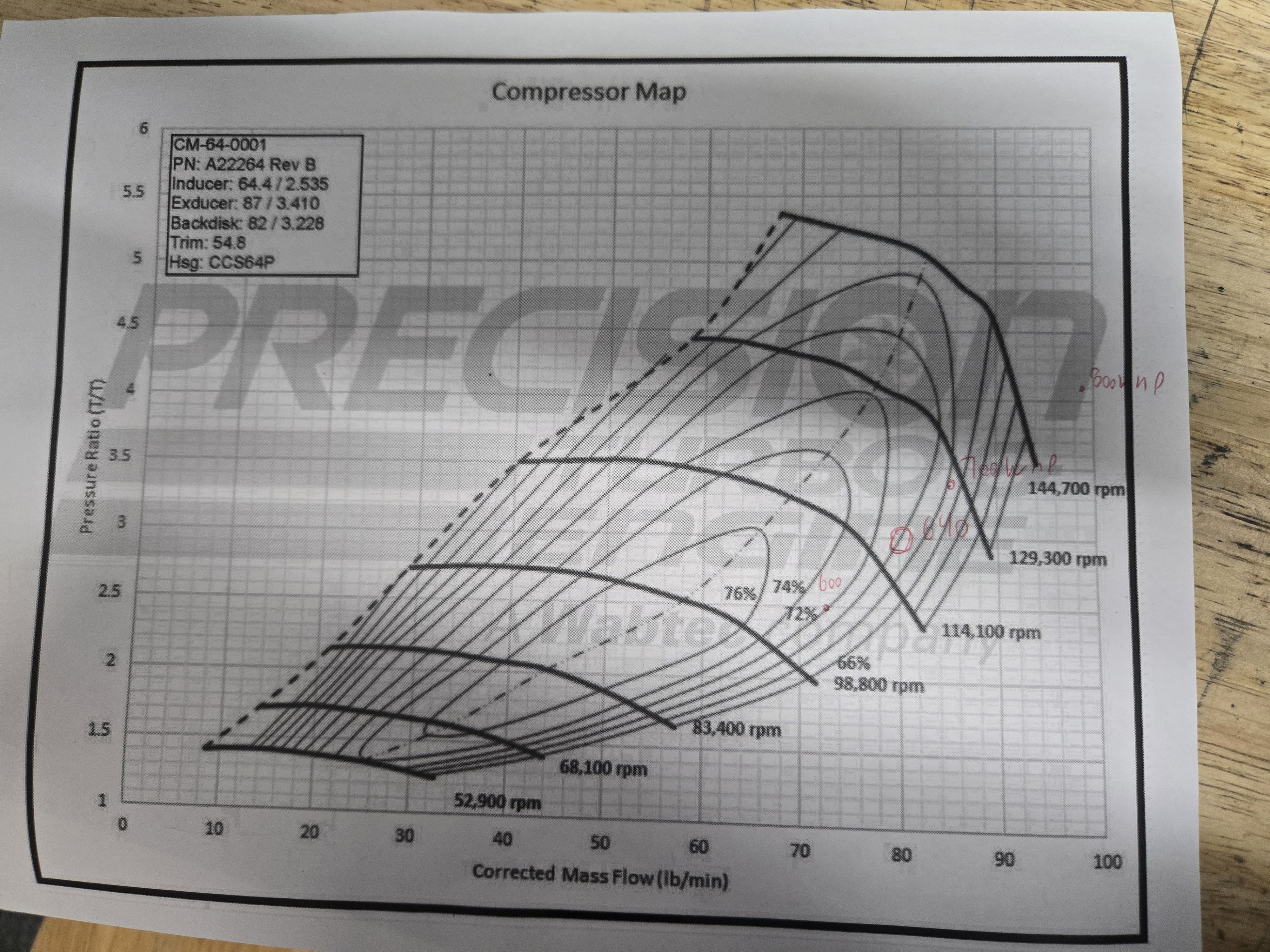

What else can I do at this point? Here's my train of thought.
- It's clear from the dyno graph that I would easily make power to 8500+RPM but I'm limited to 7600RPM. I could risk increasing my limiter, but hydro lifters have me worried. What are my options here besides going NEO head or solid lifter conversion? I'm rocking a 1.05AR turbine on my 6466. Would dropping down to a .84 help shift that power down in anyway?
- We're only seeing roughly a 30kw difference at the top end with VCT on or off. Is this normal? I want to confirm VCT is working properly.
- Should I look into other cam options?
- Should I just keep increasing boost and see if she wakes up later on? I would expect to hit 600rwkw around 35psi with my 6466.
