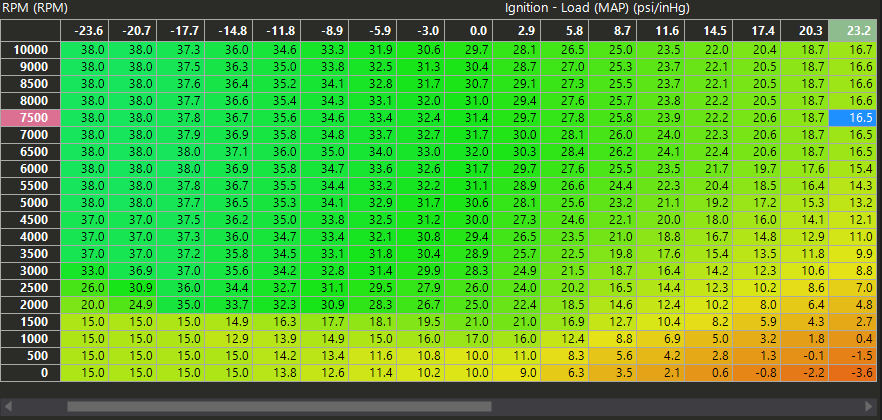

Here's my base ignition. +3 correction to redline when shooting water/meth which is always on. Looking at my old ignition table, I should be able to add 1-2 degree's next time I'm on the dyno.
Let me know your thoughts.
  • Like 1
Given you're running a 2.8 and my 2.5 is not really like for like, I suspect there could be a bit more timing you could give it.

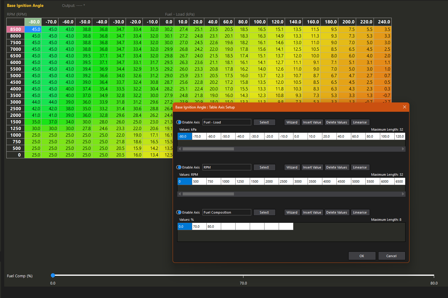

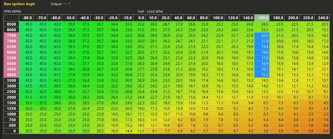

What is the kW yield per degree you're putting through it?
Here's my E85 map to give you an idea, where it was I could still get another 3~4kW per degree thrown at it.
    • Given you're running a 2.8 and my 2.5 is not really like for like, I suspect there could be a bit more timing you could give it. What is the kW yield per degree you're putting through it? Here's my E85 map to give you an idea, where it was I could still get another 3~4kW per degree thrown at it.
