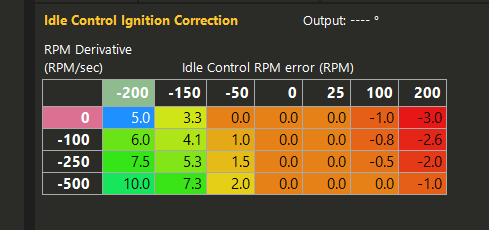

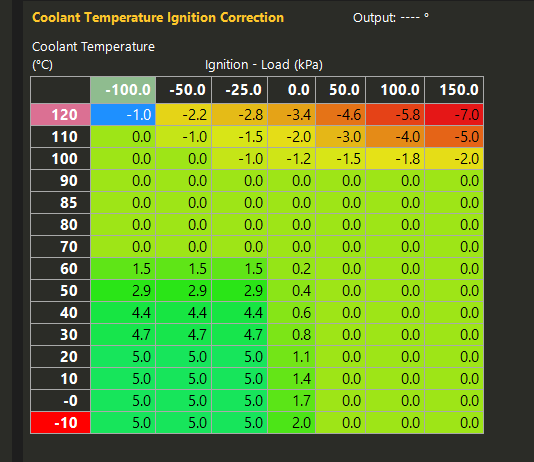

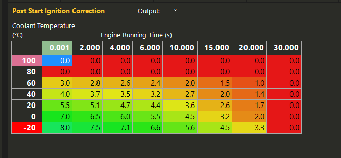

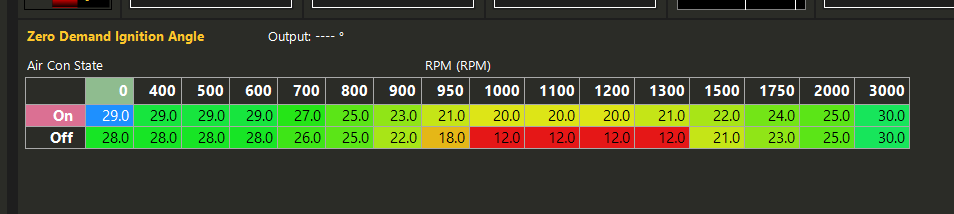

Oh that's a Haltech, however an ECU just commands fuel, spark based on the inputs it receives. So yeah, 30 to 35° of timing advance isn't out of the ordinary.
