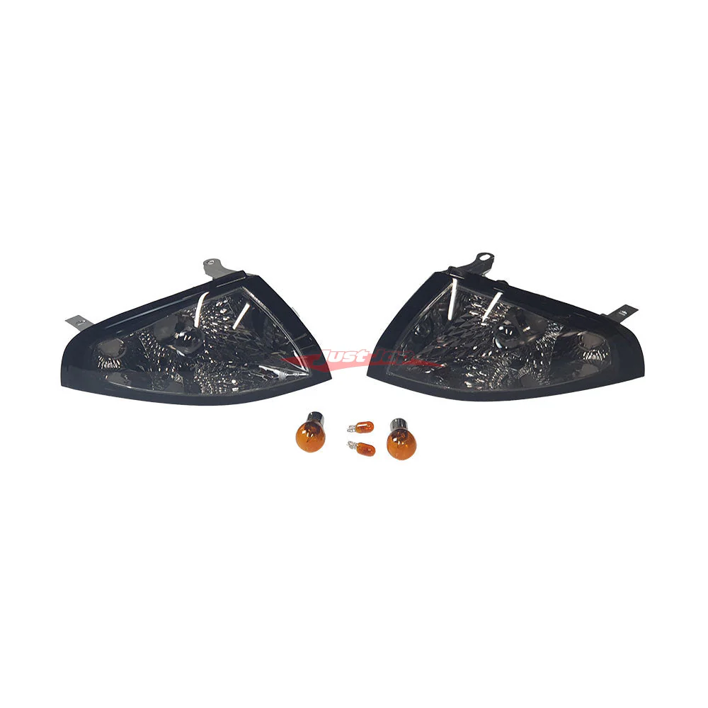

  14. Bought these recently from JustJap, but changed my mind about them. Located Melb W Subs. $100. Can post at buyer expense. (Note: no globes)
