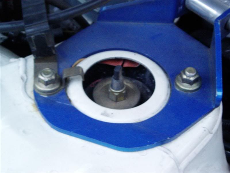

Glitch #3, this thing is toooooo loowwwwww at the front. On the last service sheet, it says "adjusted suspension", however to me, the suspension aint adjustable... It's not coil over, there's no adjusting rings, it basically looks like stock that may or may not have had inserts put in. Check out the photo of the strut top, and let me know if it's adjustable or not! If it's not I'll have to get different springs, which is just great, cause I dont have a clue of the rate of these. All i know is they are, firm, low, and blue.

Nice ride mate, Check on the suspension strut to see if it looks any different?? With adjustables i think you need a tool to wind them up and down too? did the seller give you it (if it does have adjustables) or he might of taken them out?

yeah from the underside it just looks standard. no height rings, no nothin...

Anyway, just a thought - perhaps they're like KONI's where the adjustment is made by turning the shaft off-car? Just a thought, I really don't know.
