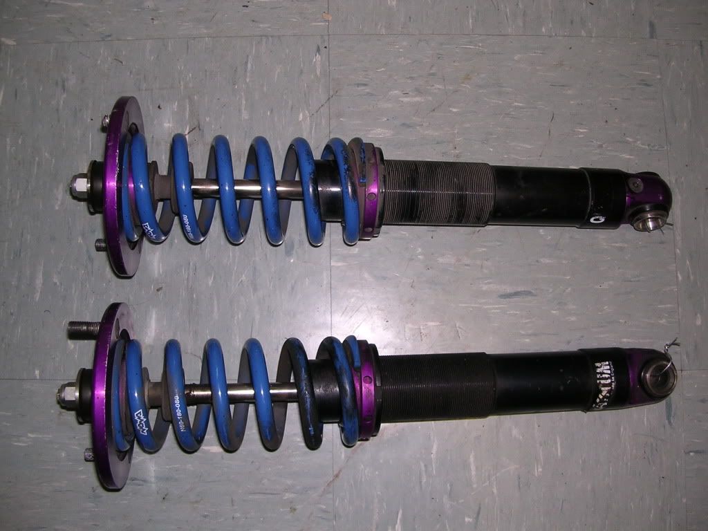

here are a couple of pics....
http://i2.photobucket.com/albums/y19/merli...um/DSCN0634.jpg
http://i2.photobucket.com/albums/y19/merli...um/DSCN0633.jpg

Just to go back on topic! I have a question about my Quantum suspension, if anyone here can tell me about this...
you can see in second picture I posted in my post above, top shock the silver alen key thing on the bottom, i've been told this adjusts the rebound dampening
as far as i understand, top = compression dampening, bottom = rebound dampening
so, how should i go about adjusting both the settings? and what sort of balance am i looking at?
I have no idea what settings the bottom ones are on, i'll have to check,
any info would be great! cheers...
