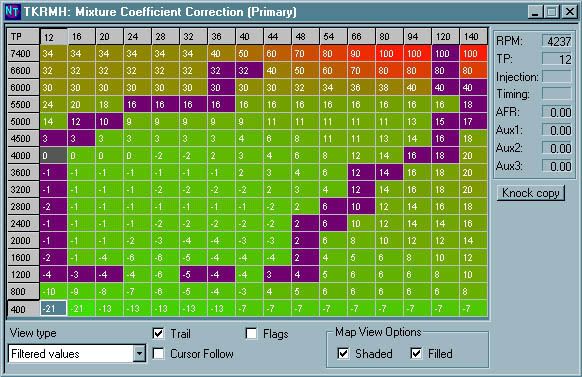

The question that always comes up..... how fine is the tuning resolution?
Really hard to quantify as there is much more to how an ecu works other than just how many map points it has.
In short its on par with power fc, in some areas the factory ecu is better. A lot of people like the knock feedback from the power fc. Personally i like the active retard vs knock facility of the factory ecu.
Much better than cheap/old standalones like microguess etc.
Probably not fair and a little difficult to compare directly to big players like motec, autronic. Let's face it if you can afford to purchase, install and tune a motec then you are playing in a different league.
The factory ecu's (even the old R31's) have at the minimum a 16x16 point map for timing and another 16x16 map for fuel. Cars made from around 1990+ have at least 2 maps each for fuel and timing.
The load points and rpm points can be user defined to cover any scale you desire (within reason).
Example fuel map with trace.....rb20det approx 210rwkw......
The factory ecu's ability to control injectors double the standard size and maintain perfect cold start and idle when tuned correctly is remarkable.
Besides the obvious timing and fuel maps there are numerous other tables for controlling idle speed, A/C and P/S switching, decel fuel cut/recover, temp vs enrichment, accel enrichment, fuel cut (aka boost cut), max speed, max rpm, etc, etc... well you get the idea. All the things you would expect.
One of the nice things about the factory ecu is how resilient it is to problems. Bad fuel, bad sensor, etc... fault/limp mode will still do its best to get you home with your engine in one piece.
Edited by TSL
