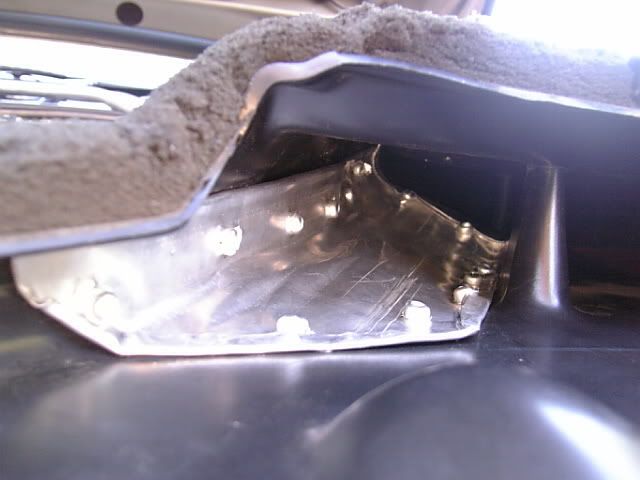

Sorry guys,let me clarify.On a post on page 2 I said that I had a dyno run with no lid,that was with bonnet up.Obviously that would make a big difference in temps.But the run with 2kws less was with bonnet closed.So the setup really isn`t to bad.Three inch pipe from old cooler hole to underside of snorkel.Clamp both ends using pvc pipe connectors.Then cut small hole in front of lid facing headlight about 1'' by 3".Yes I know it isn`t perfect due to a little under bonnet temps but it does get me close to no lid at all.

Exactly what I did but put a flexable tube from from old cooler hole in guard to underside of snorkel between the curve of the cooler pipe and the air box.To make up for lost intake width.

i just used the radiator air deflector with scoop to compensate

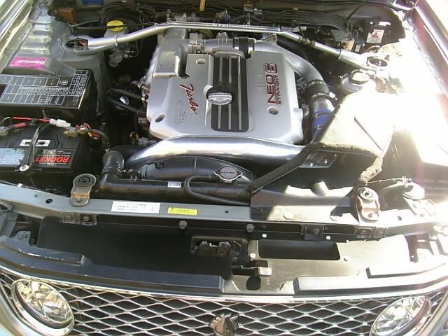

Hey EGA41T - I see your pipe that comes over the radiatorhas a nice bend back downwards after going over the radiator fan. Mine heads upwards and doesn't come back down - hitting the bonnet a little.
Because yours bends back down it means you didnt have to take quite as much out of your snorkel. Did your pipe come like that or did you get the pipe bent afterwards?

- mine is a justjap kit..
