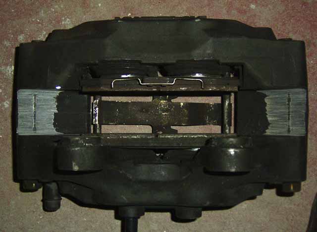

yep, it's me. going to try for 340mm 2 piece rotor, standard GTR sumitomo caliper.
If you want the pads to sit on the disc properly you will need to grind out the inside radius of the caliper or the pad will overhang. Like this:
http://www.driftshop.com.au/twinvl/pics/modedcalliper2.jpg
I'm not sure how they will go over 340mm discs, here is a pic of GTR calipers on 330x32mm discs, as you can see they sit out alot and they 'just' don't quite fit under 16" rims!
