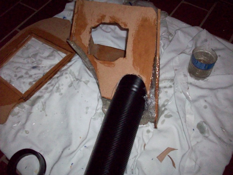

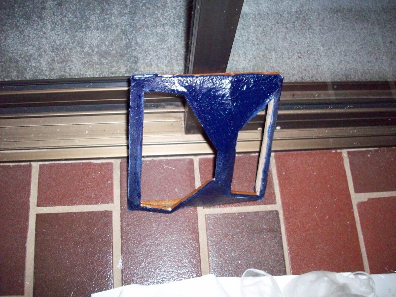

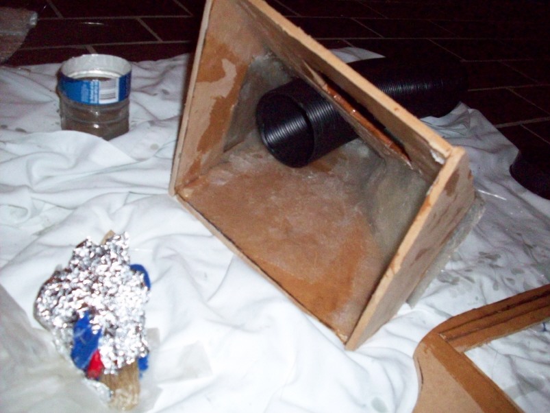

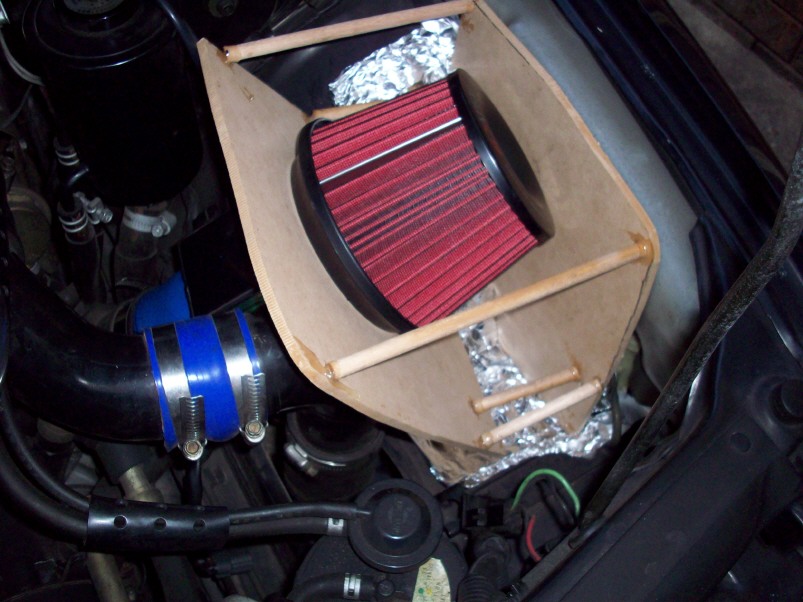

Here's my attempt after being defected for pod without enclosure. :) Not finished yet, but almost there. Just sand and paint.
Mine is a tight fit.

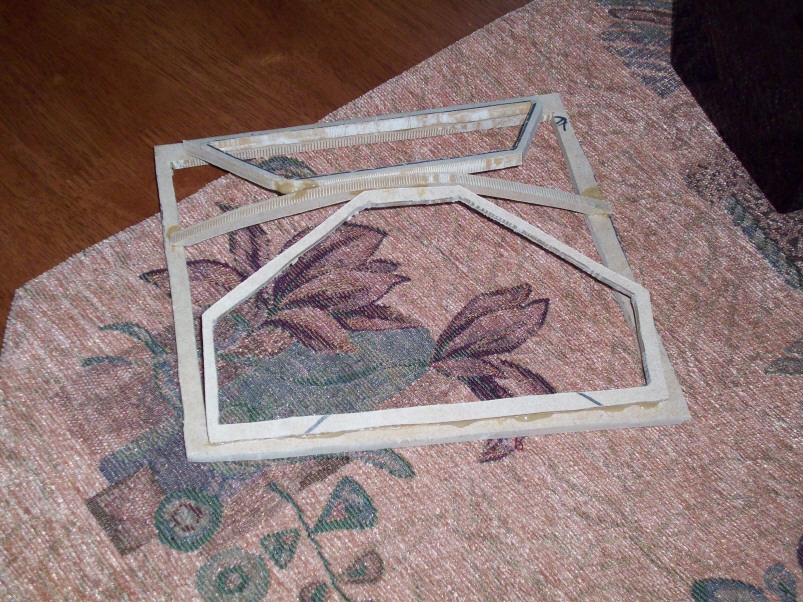

Here's some progress pics.
Pics of part of the lid, which will have perspex in the spaces left.

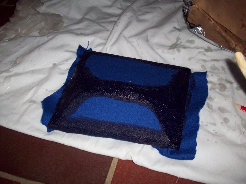

Fleece stretched to frame, and soaked in resin.
Base of the enclosure. Filling up some gaps with fibreglass.
Using plastic hose for the cai. Got it from Autobahn for $25. Can be bent and extended upto 1m, and seems to be out of tough plastic.
