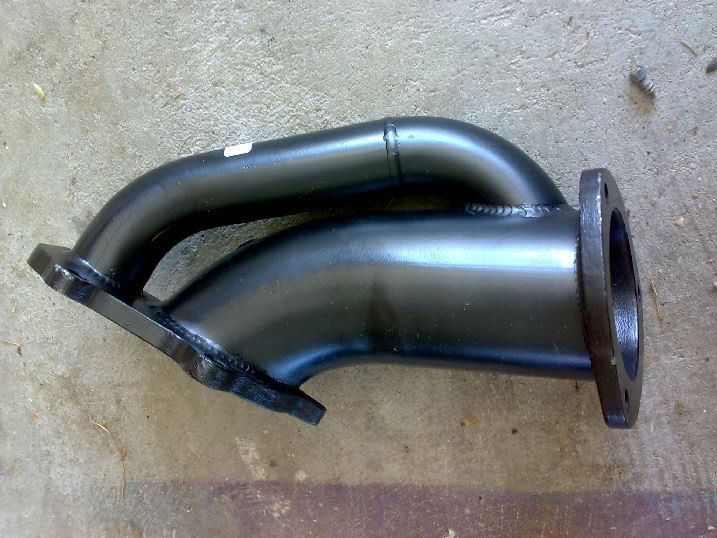

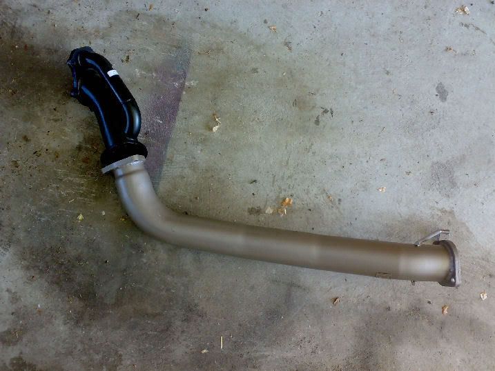

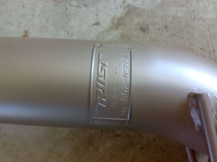

Mmmm Trust front pipe... And split dump. :P

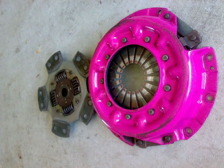

Exedy Hyper single ceramic button... (flywheel machined too).

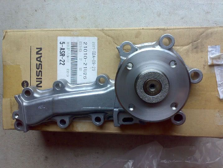

Genuine Nissan water pump (had too many problems in the past with inferior water pumps).

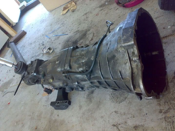

Gearbox and tailshaft ready to go back in... (Note the "custom" crossmember).

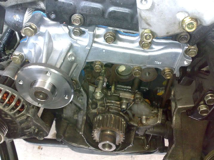

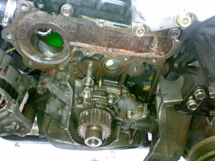

Front of the motor - Naked! :)
New water pump installed.

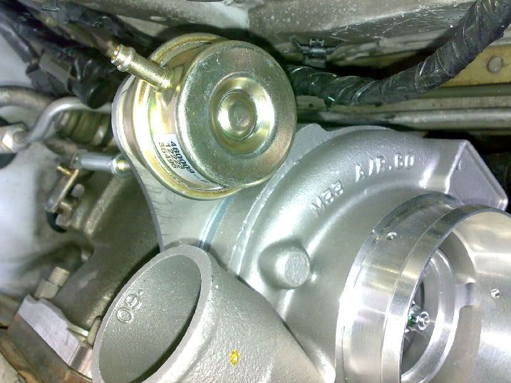

Wastegate actuator mount and connector pin had to be modified to get them into the right position.
