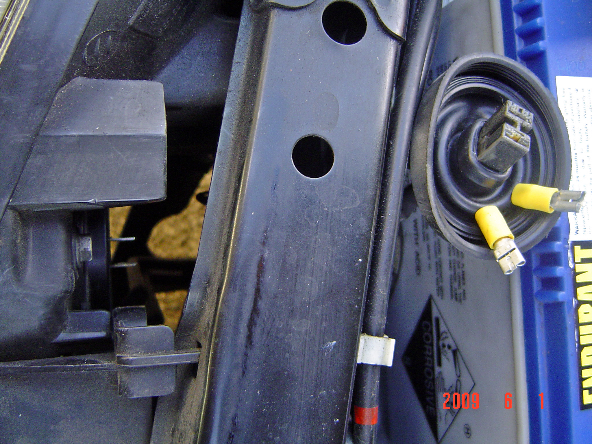

There is a plastic screw cap that holds in a rubber boot but i think they only have to come off to change the bulb. the twin wires from the loom end in a black plastic plug which looks as though it just plugs into the back of the bulb although i haven't been able to pull it out to check without removing at least the battery clamps if not the whole battery ( I don't have very nimble hands).
https://www.sau.com.au/forums/topic/272506-headlights/#findComment-4627080
attachment=226152:DSC01990_edited.JPG] I haven't pulled the bulb out to verify that it is the same as oddy man's but as that is printed on top of the light unit it seems likely. In that case you don't really need the plug (shown in the middle of the rubber boot) but just get a couple of terminals (like the yellow ones in the photo and crimp or preferably solder them to the ends of your wires and then push them on to the connectors sticking out of the bulb (just visible in the photo to th right of the bolt head in the middle left hand side).
